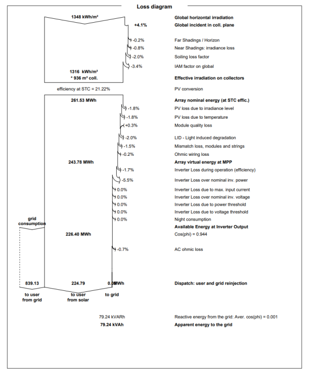

  1. I would like to model a PV system with dynamic clamping (i.e. no electricity reinjected into the grid). The building’s consumption data has been uploaded in the “self-consumption” section. In the “energy management” sections, the grid limitation has been set to 1 kW with the option “limit at the injection point” (since setting the limit to 0 kW did not trigger any clamping). In the loss diagram, the active energy injected into the grid is correctly shown as 0 MWh. However, the apparent energy injected is not equal to zero. How can this be explained? Thank you in advance.
