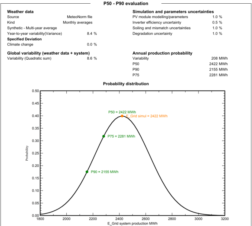

  4. I have here this P50-P90 report. What is the meaning of variability and why does it have a value of 208 MWh?
