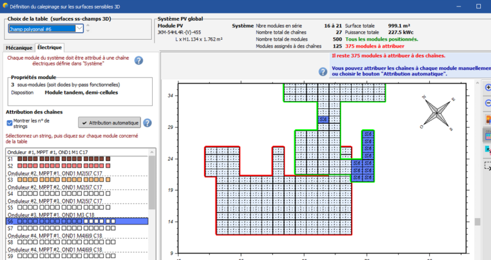

  1. @Michele Oliosi Thanks for your reply. Ok, I will use the automatic attribution. Sometimes the automatic attribution doesn’t do what I want. So, I’ll patiently wait for the next update when it’s fixed.
  2. Oh, I thought I would be notified when I got a response. Basically, I have two PV module arrays. One array is on top of the other array, which is why they overlap. So, when I want to manually create an electrical string with my mouse, I can only modify the modules from the bottom array in the area where they overlap
  3. Hello, when I’m doing the electrical layout, I notice that some modules are overlapping. Screenshot below. Could you tell me if there is a solution, because I can’t create a module string for the upper PV field.
