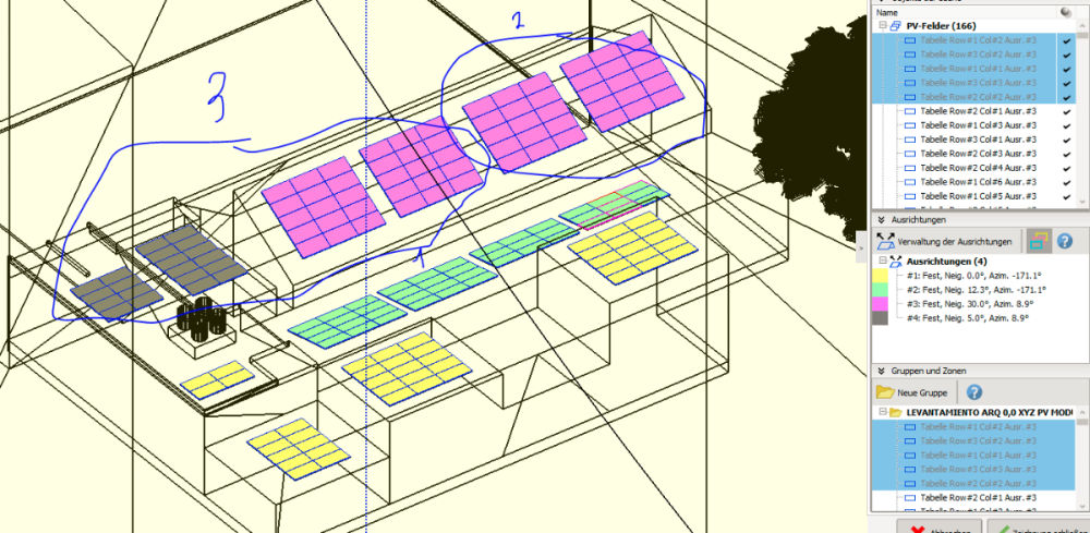

  2. Dear all, I am trying to string my sub arrays to specific MPPs. However for simulation I am forced to pick a inverter for all orientations which results in over or under dimensions for this orientation. Cosequently it does not allow me to simulate and make use of the inverters I need. Specifically I require that area three makes use of one SMA Tripower 25kw with 3 MPPs. How can I avoid to be forced to pick a inverter for grey area and use one inverter for both? Side questions: How do I combine the pv fields to a larger group, having 8 instead of 166? I really appreciate some help as I could not figure this limitation out. want.
