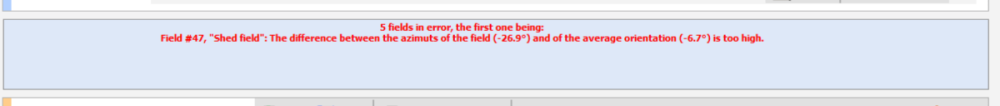

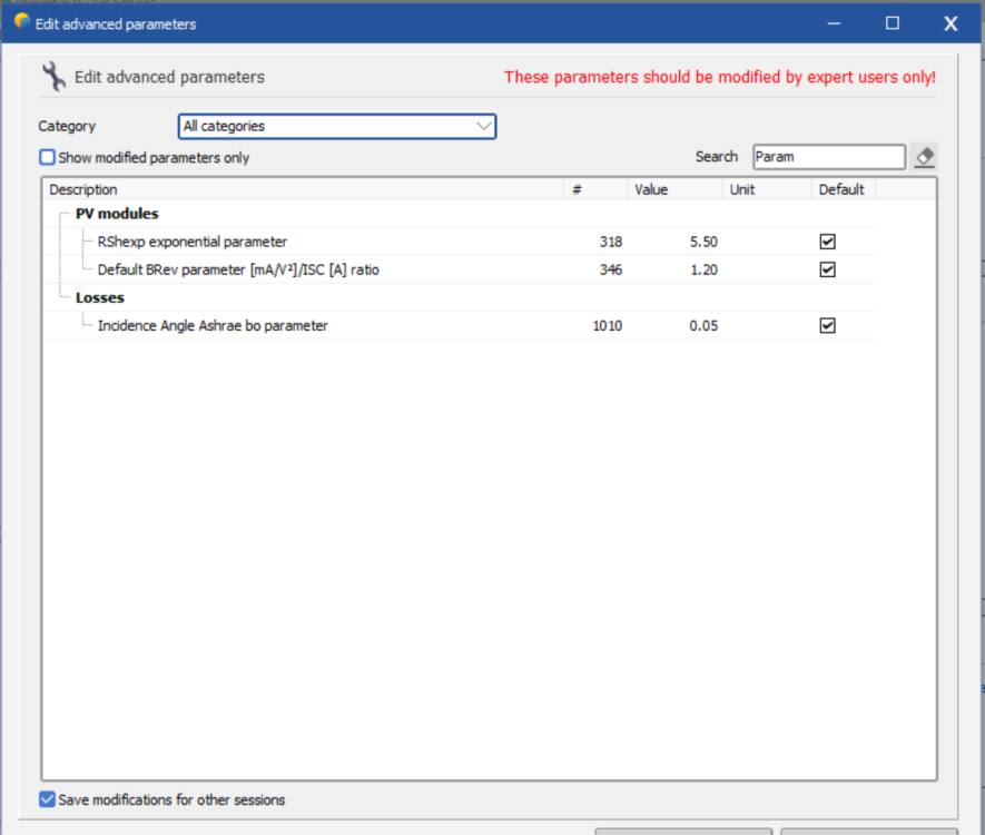

  2. Good Morning. I am using PVsyst 8.0 and I am geting the same error. However seems that in advanced project settings the parameter Param_Azim Spread Max is not anymore. How is the procedure with the new version.
