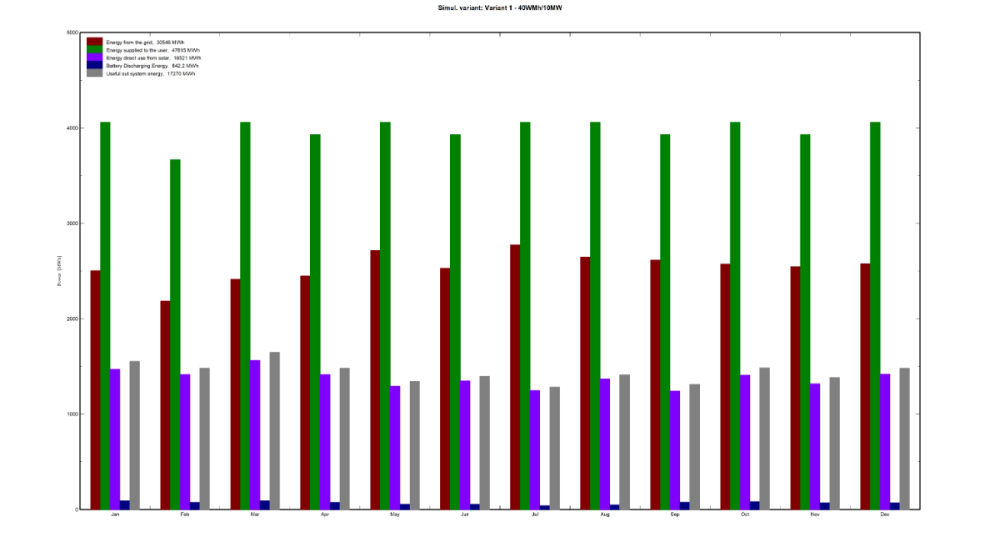

  5. Thank you for clearing this. Is there any relationship between the values EDirUse, EBatDis, E_Solar, and E_User? I am trying to find what is the generation from the BESS and solar (only) as per hour values and add it to gain the total energy (E_Solar). I have attached the hourly generated graph and table FYI.
