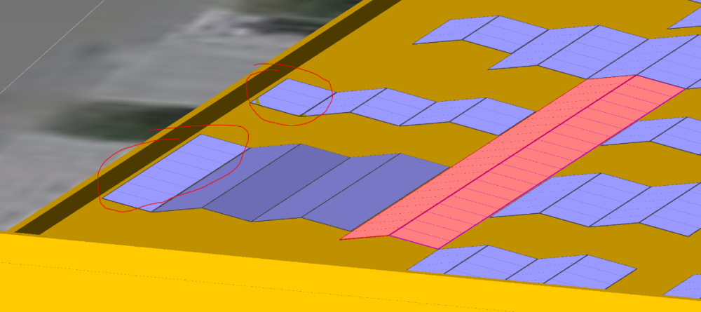

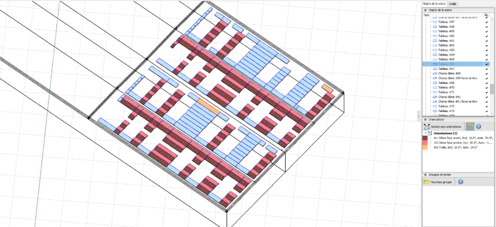

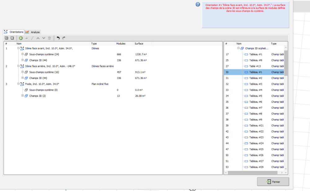

  1. Hello Jeremie Thank you for your answer. I have downloaded PVsyst 8.0.5 and I can indeed convert my domes to fixed tables. Nethertheless, I still can't affect the right orientation for these fixed tables as it automatically creates a third orientation. (see below) As you can see the domes that I have converted are not colorized (still blue) and turn orange when given orientation 3 When I enter the orientation management tool, I can't switch orientations from third orientation to orientation 1 unfortunately. Do you have any clues ? Thank you for your help.
  2. Hello I have chosen East-West orientation for my project so I have created domes in my 3D shading model. One of my PV fields ends "going up" meaning my dome is cut into half. Its seems we can't creat half domes, so I have created a fixed tilt plane instead. My issue here is that PVsyst doesn't allow me to chose the orientation corresponding to the east orientation of my domes. I end up having to define 3 orientations even though I have only got 2. This will be an issue when defining my system since I can't define a string with my third orientation (not enough modules to make a string). What should I do ? Thank you for your help.
