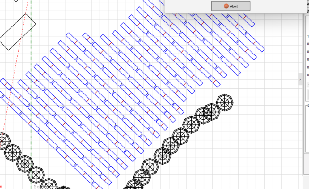

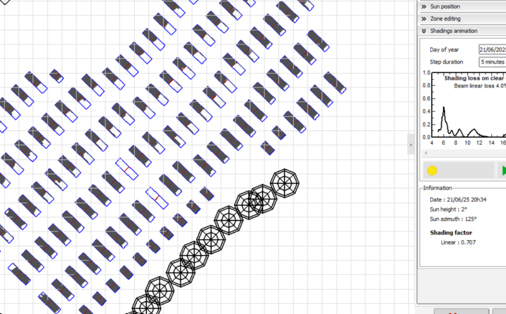

  3. Hello PVsyst team, I am working on an Agri PV project where i have to respect the sense in which the crop is planted. Given that the crop is planted at -46.2°, i have to install my trackers accordingly. See picture below. The issue is that when I import the PVC scene on PVsyst and simulate the shading animation, the rotation axis used by PVsyst is N-S axis (as if the middle of the tables is the centre of of the rotation from south-east to north-west) while the intended rotation is supposed to be north-east -> south west) see picture below : (I'm putting the middel and the End of the simulation)
