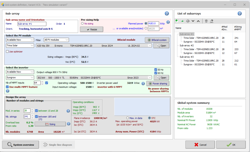

  1. Noted, it means I have to un-tick the box of " Use multi-MPPT feature"?
  2. Hi Lazare, For example,sub array 1, I wanted to maintain the 4183kWp , however when I click resize, it maintains the number of inverter and increases the DC/AC ratio to 1.3 instead. Please see below: Kindly advise how to work around it and manually increase the number of inverter?
  3. Hi Lazare, I am aiming to maintain the power with 1.2 DC/AC Ratio.
  4. Hello, I am simulating a 12.5MWp ground mounted system, the following are the components based on layout: 20160 modules x 620Wp 35 inverters of Sungrow SG320HX -20@50 deg C When I simulate it maintaining a 1.20 DC/AC ratio it can only provide me 11.58MWp, 18676 modules and 32 units of inverters. Kindly advise how I can match the 12.5MWp capacity which is based on the layout and the max cap we can put on the area? Additionally how I can increase the number of my inverters to 35 x SG320HX -20@50 deg C? looking forward to your kind assistance.
