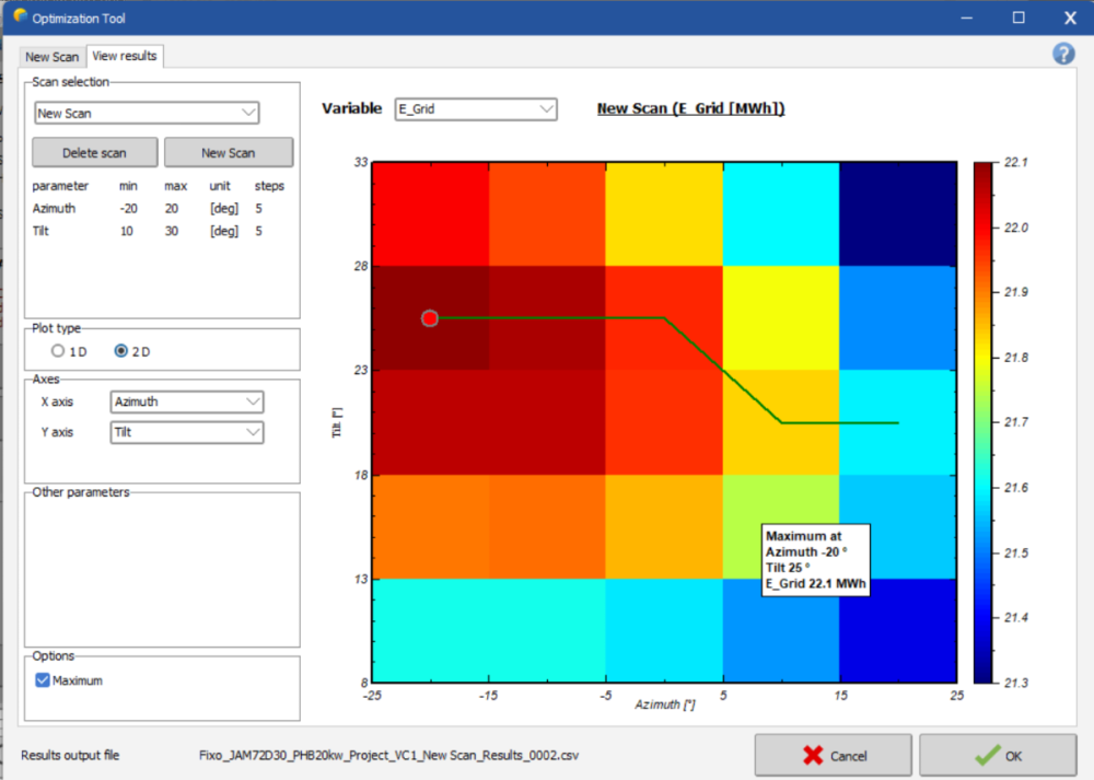

  1. Hello everyone! I hope you're all doing well. I have two questions regarding the Advanced Simulation Tool in PVSyst: Table Rotation Method: Question: How does PVSyst handle the rotation of tables within the Advanced Simulation Tool? Specifically, does it rotate each table individually, or does it rotate all tables collectively using the system's center of mass? Azimuth Simulation Range: Question: When I set the simulation range for azimuth (e.g., from -20° to +20°), does PVSyst take into account the azimuth specified in the orientation settings? For instance, if the azimuth of the tables is set to 16°, will PVSyst simulate azimuth angles ranging from -4° to +36°? Context: I'm currently conducting optimization tests and have been observing some unexpected results. Understanding these aspects of the simulation tool is crucial for accurately interpreting my findings. Any insights, explanations, or references to relevant sections of the PVSyst documentation would be greatly appreciated! Thank you in advance for your assistance. Best regards, Maruyama
  2. Just to illustrate the darin's post, there are two pictures.
