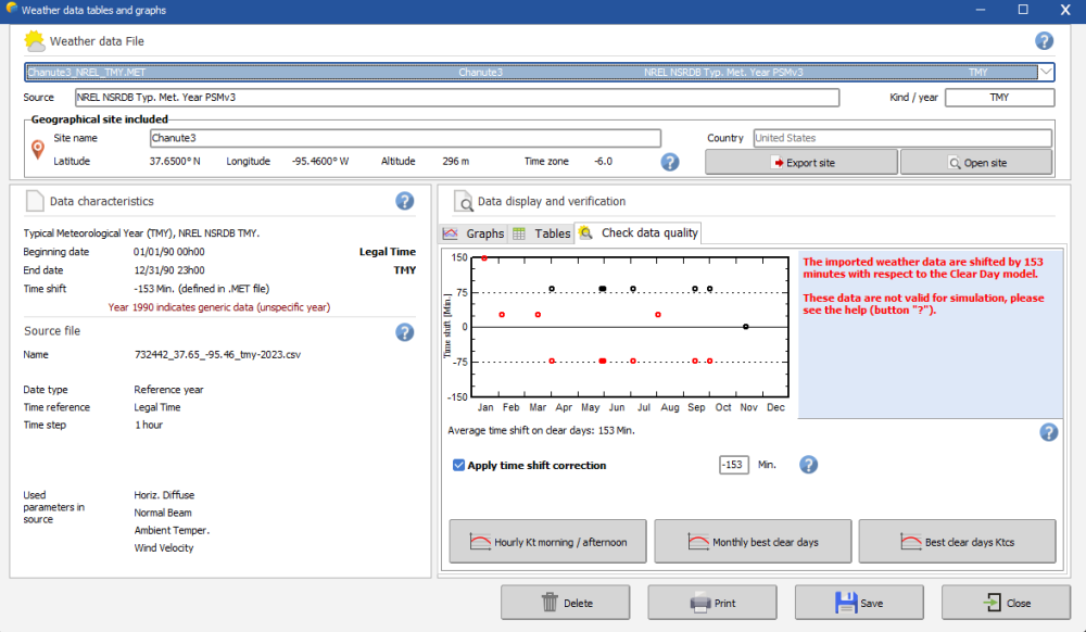

  4. Hi Linda, I'm not sure how to add a time zone to the datafile in a fashion that would be read by the software. I'll go ahead and email the data file to support@pvsyst.com and reference this thread. Thanks!!
  5. Hi Linda, Here is how I have been doing it. This is the very first step I take when I start each project so there is nothing else in the project file yet. Click on Known Format below: Click on "Choose" below: Select file from NREL: File looks like this: Enter site name, select country, click "Get From Coordinates", click "Import". Then this file is created. Which has the offset: This process was working. Would you suggest something different?
  6. I'm getting a similar error. I am importing a file from NREL. I'm using version 8.0. 153 seems like a strange amount to be off. There is no "date tab" that I can see in the raw data file. Also, I can take the -153 minutes out of this screen but if I click "Save", it just reverts back. Any suggestions? The NREL file looks normal and I've downloaded 3 separate files and they all throw an error like this.
