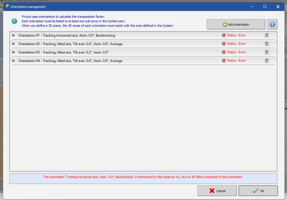

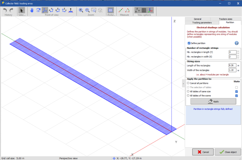

  1. but if pvsyst created the orientation , how can i define the systemm part for each orientation?? i sent you now the zip file
  2. can someone respond me? I'm waiting for two days ,how can i resokve this problem??
  3. However, I only have one orientation. I am not satisfied with the new update of PVsyst; I think the previous version (7) was better than the 8 .

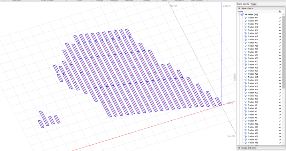

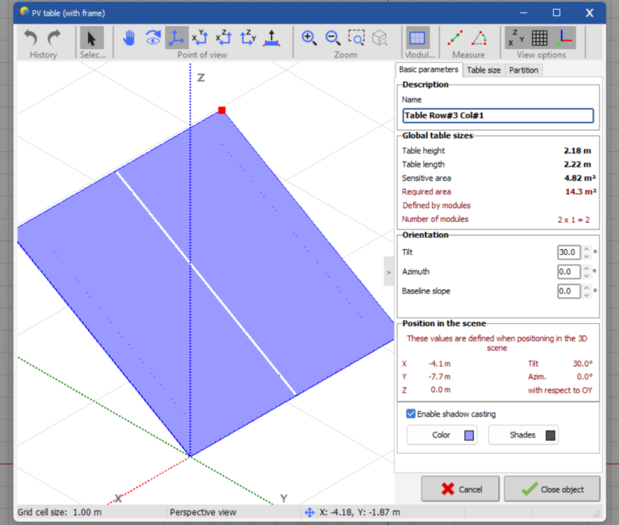

  4. I imported a PVC file from VirtoCAD into PVsyst 8.0.9, but during the simulation, I got an error stating that there are two orientations. ''the orientation tracking horizontal axis,azim 00 backtracking is referenced by the subarray 1,but no 3d field is attached to this orientation'' but i didnt add all these orentation that you can see in the photo .... in pvsyst 8.0.9, can anybody resolve this problem?

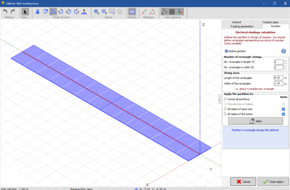

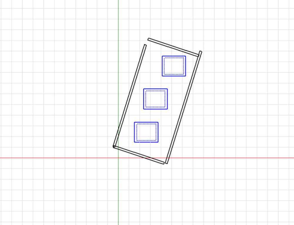

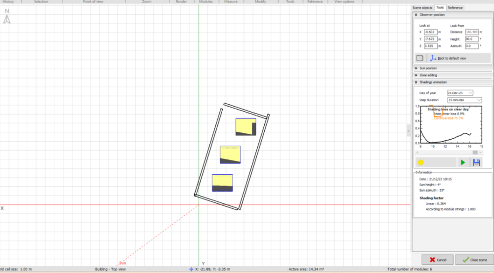

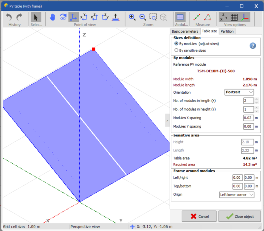

  5. I’m currently working on a small rooftop photovoltaic system with a total capacity of 3 kW, consisting of 6 modules of Trina solar , 500Wp (Portrait). I’ve noticed that the electrical losses reported in my simulation seem quite significant, as shown in the attached screenshot. Given the size of this system, I’m wondering if it’s necessary to consider electrical losses in detail or if I should implement the partition define feature in PVsyst for this setup. Should I be concerned about these electrical losses for such a small system? Is partitioning a worthwhile approach for a 3 kW rooftop installation, or would generalized assumptions be sufficient? Any insights or recommendations would be greatly appreciated! Thank you! Sherry

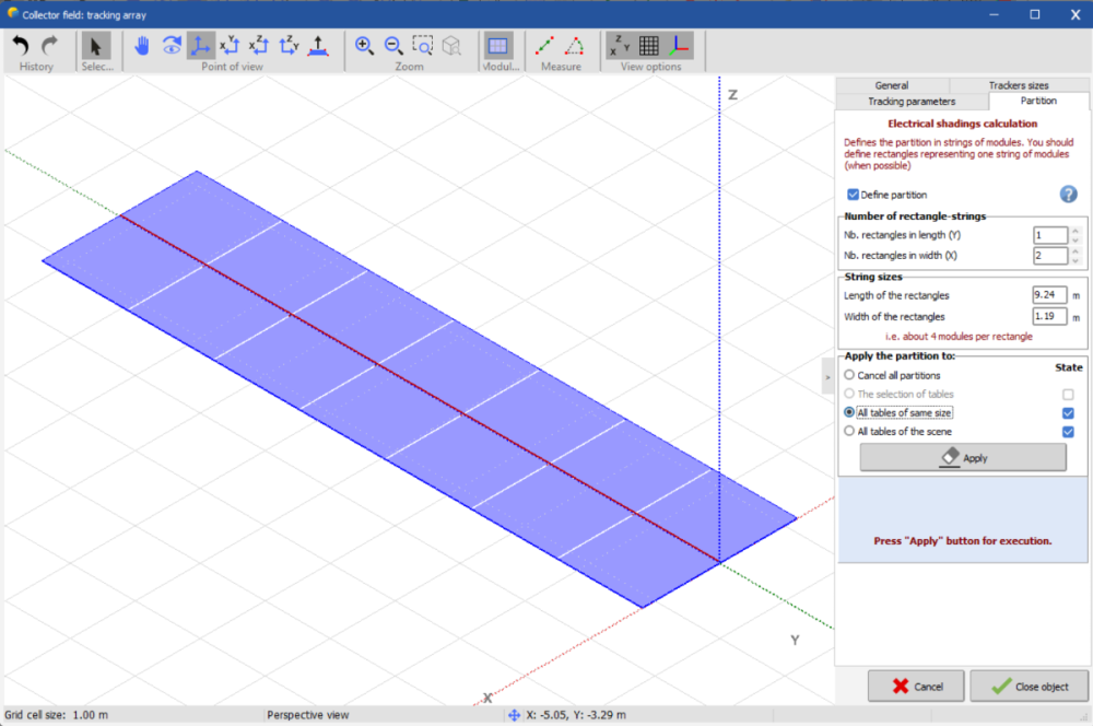

  6. or should i put , y:1 and x:28 , Y:1 X:14 ..? really confused
