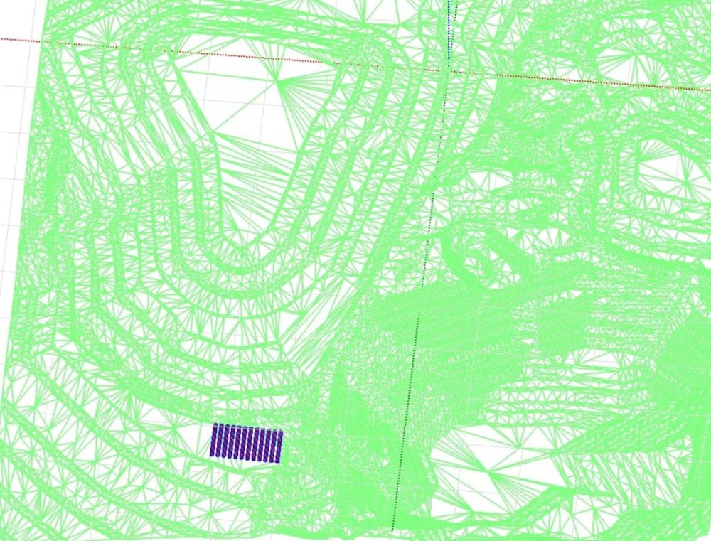

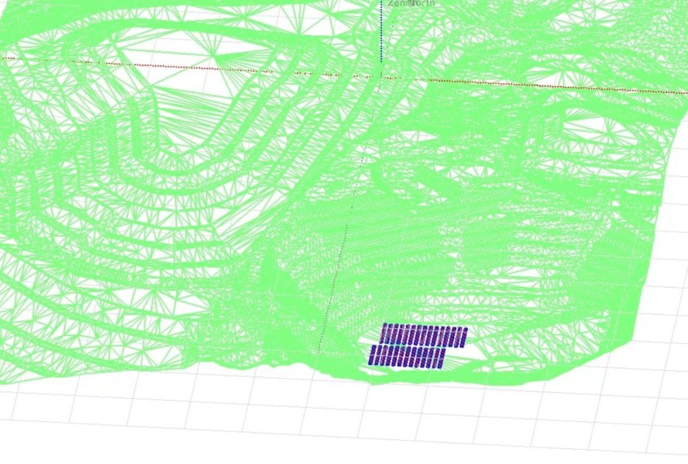

  5. We want to study the impact of the shadings of the ground in the pv objects, but when reviewing the shading factor table, it is full of zeros or very low values, that makes us suspect that the shade produced by the ground is not being considered. The horizon seems to not consider these ground differences because they are man made and too close to the pv field. How can I consider the shade of the ground? (consider this project is located in the south from the Ecuator)
