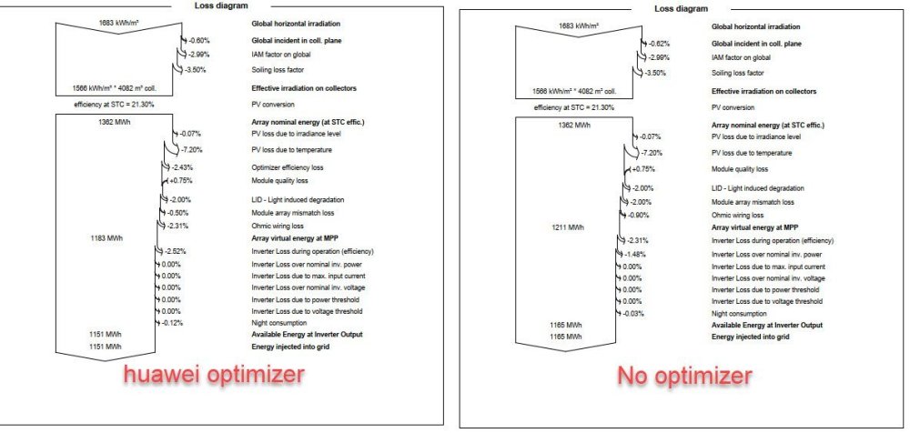

	Thank you very much. I would like to ask one more question. If it is the same with Solaredge optimizer, do I need to make it shaded to see the difference without Solaredge optimizer?
	Why is it that when I simulate an installation with Optimizer Huawei and an installation without Optimizer Huawei installed, the power consumption of Optimizer Huawei is lower than without Optimizer Huawei installed, even though it is actually installed with Optimizer Huawei? should be better

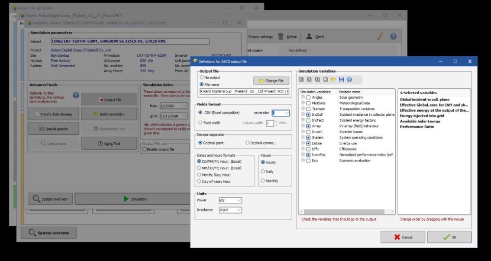

	I have a question about using Simulation parameters.somkiat chamsakorn replied to somkiat chamsakorn's topic in How-to Where can I find the 15-minute energy parameters?

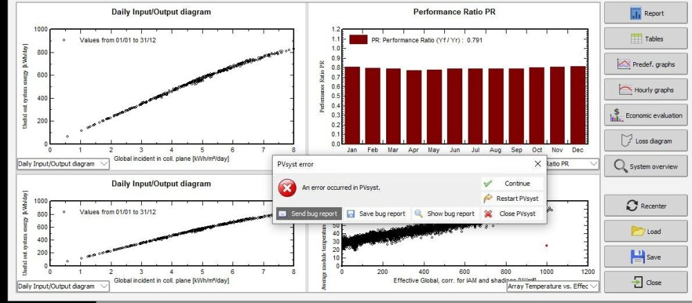

	date/time : 2024-08-13, 22:25:14, 391ms operating system : Windows 10 x64 build 19045 system language : English system up time : 18 days 11 hours program up time : 9 minutes 24 seconds processors : 4x Intel(R) Core(TM) i7-6700 CPU @ 3.40GHz physical memory : 1561/4095 MB (free/total) free disk space : (C:) 6.12 GB display mode : 1920x1200, 32 bit process id : $323c allocated memory : 465.80 MB largest free block : 129097.98 GB executable : PVsyst.exe exec. date/time : 2024-07-17 16:32 version : 7.4.8.38383 compiled with : Delphi 11 madExcept version : 5.1.3 registered owner : Windows User user name : pvsyst computer name : ENMAX-PVSYST activation key : v7-00db6caa3ead1c1d7e5f2865cb09d42c (end of licence: 2025-05-28) release date : 17/7/2024 contact name : somkiat chamsakorn contact email : somkiat.0741@gmail.com callstack crc : $579e1e66, $2d68ef39, $2d68ef39 exception number : 1 exception class : EAccessViolation exception message : Access violation at address 00000000019740B9 in module 'PVsyst.exe'. Read of address 0000000000000038. main thread ($2ec8): 019740b9 +099 PVsyst.exe Sim.VarD 5750 +2 TVarSimul.Libelle 02cd1abb +90b PVsyst.exe Res.ResultPlotHorF 385 +161 TResultPlotHorForm.OnExecute 01c4a893 +053 PVsyst.exe Form.AncF 968 +9 TFormAnc.Execute 02cd119b +00b PVsyst.exe Res.ResultPlotHorF 214 +2 TResultPlotHorForm.Execute 02ce4647 +037 PVsyst.exe Res.ResultF 1086 +2 TResultForm.OnClickHourlyGraphs 0078ff40 +0a0 PVsyst.exe Vcl.Controls TControl.Click 007cf936 +026 PVsyst.exe Vcl.StdCtrls TCustomButton.Click 009ed716 +0c6 PVsyst.exe Vcl.Buttons TBitBtn.Click 007d11c2 +022 PVsyst.exe Vcl.StdCtrls TCustomButton.CNCommand 00a0bd3b +01b PVsyst.exe PngBitBtn 297 +2 TPngBitBtn.CNCommand 004d0ee1 +041 PVsyst.exe System TObject.Dispatch 0078f84d +35d PVsyst.exe Vcl.Controls TControl.WndProc 00796d02 +962 PVsyst.exe Vcl.Controls TWinControl.WndProc 007cf34d +08d PVsyst.exe Vcl.StdCtrls TButtonControl.WndProc 0078f350 +030 PVsyst.exe Vcl.Controls TControl.Perform 00796ee9 +029 PVsyst.exe Vcl.Controls DoControlMsg 007980a3 +013 PVsyst.exe Vcl.Controls TWinControl.WMCommand 00920753 +053 PVsyst.exe Vcl.Forms TCustomForm.WMCommand 004d0ee1 +041 PVsyst.exe System TObject.Dispatch 0078f84d +35d PVsyst.exe Vcl.Controls TControl.WndProc 00796d02 +962 PVsyst.exe Vcl.Controls TWinControl.WndProc 0091b5d7 +9d7 PVsyst.exe Vcl.Forms TCustomForm.WndProc 00795e3a +02a PVsyst.exe Vcl.Controls TWinControl.MainWndProc 006a9e23 +023 PVsyst.exe System.Classes StdWndProc 7ff93473 +0d5 user32.dll SendMessageW 007e03cf +04f PVsyst.exe Vcl.StdCtrls TButtonStyleHook.DoClick 007e08a5 +035 PVsyst.exe Vcl.StdCtrls TButtonStyleHook.WMLButtonUp 004d0ee1 +041 PVsyst.exe System TObject.Dispatch 008cf564 +1b4 PVsyst.exe Vcl.Themes TStyleHook.WndProc 008cf8b2 +012 PVsyst.exe Vcl.Themes TMouseTrackControlStyleHook.WndProc 007e04c0 +090 PVsyst.exe Vcl.StdCtrls TButtonStyleHook.WndProc 008ce8c5 +085 PVsyst.exe Vcl.Themes TStyleHook.HandleMessage 009d6ab0 +0c0 PVsyst.exe Vcl.Styles TStyleEngine.HandleMessage 008c9b6b +07b PVsyst.exe Vcl.Themes TStyleManager.HandleMessage 00794004 +024 PVsyst.exe Vcl.Controls TWinControl.DoHandleStyleMessage 00796455 +0b5 PVsyst.exe Vcl.Controls TWinControl.WndProc 007cf34d +08d PVsyst.exe Vcl.StdCtrls TButtonControl.WndProc 00795e3a +02a PVsyst.exe Vcl.Controls TWinControl.MainWndProc 006a9e23 +023 PVsyst.exe System.Classes StdWndProc 7ff93473 +254 user32.dll DispatchMessageW 0092a5ce +12e PVsyst.exe Vcl.Forms TApplication.ProcessMessage 0092a643 +013 PVsyst.exe Vcl.Forms TApplication.HandleMessage 0092336b +2bb PVsyst.exe Vcl.Forms TCustomForm.ShowModal 01c4a8a4 +064 PVsyst.exe Form.AncF 969 +10 TFormAnc.Execute 02cdeab0 +040 PVsyst.exe Res.ResultF 282 +6 TResultForm.Execute 02f2d2d6 +0c6 PVsyst.exe Prj.MainF 4668 +14 TProjectForm.OnClickResults 006a88f0 +020 PVsyst.exe System.Classes TBasicAction.Execute 00761785 +0c5 PVsyst.exe Vcl.ActnList TCustomAction.Execute 006a85aa +04a PVsyst.exe System.Classes TBasicActionLink.Execute 0078ff23 +083 PVsyst.exe Vcl.Controls TControl.Click 007cf936 +026 PVsyst.exe Vcl.StdCtrls TCustomButton.Click 009ed716 +0c6 PVsyst.exe Vcl.Buttons TBitBtn.Click 007d11c2 +022 PVsyst.exe Vcl.StdCtrls TCustomButton.CNCommand 00a0bd3b +01b PVsyst.exe PngBitBtn 297 +2 TPngBitBtn.CNCommand 004d0ee1 +041 PVsyst.exe System TObject.Dispatch 0078f84d +35d PVsyst.exe Vcl.Controls TControl.WndProc 00796d02 +962 PVsyst.exe Vcl.Controls TWinControl.WndProc 007cf34d +08d PVsyst.exe Vcl.StdCtrls TButtonControl.WndProc 0078f350 +030 PVsyst.exe Vcl.Controls TControl.Perform 00796ee9 +029 PVsyst.exe Vcl.Controls DoControlMsg 007980a3 +013 PVsyst.exe Vcl.Controls TWinControl.WMCommand 004d0ee1 +041 PVsyst.exe System TObject.Dispatch 0078f84d +35d PVsyst.exe Vcl.Controls TControl.WndProc 00796d02 +962 PVsyst.exe Vcl.Controls TWinControl.WndProc 00795e3a +02a PVsyst.exe Vcl.Controls TWinControl.MainWndProc 006a9e23 +023 PVsyst.exe System.Classes StdWndProc 7ff93473 +0d5 user32.dll SendMessageW 007e03cf +04f PVsyst.exe Vcl.StdCtrls TButtonStyleHook.DoClick 007e08a5 +035 PVsyst.exe Vcl.StdCtrls TButtonStyleHook.WMLButtonUp 004d0ee1 +041 PVsyst.exe System TObject.Dispatch 008cf564 +1b4 PVsyst.exe Vcl.Themes TStyleHook.WndProc 008cf8b2 +012 PVsyst.exe Vcl.Themes TMouseTrackControlStyleHook.WndProc 007e04c0 +090 PVsyst.exe Vcl.StdCtrls TButtonStyleHook.WndProc 008ce8c5 +085 PVsyst.exe Vcl.Themes TStyleHook.HandleMessage 009d6ab0 +0c0 PVsyst.exe Vcl.Styles TStyleEngine.HandleMessage 008c9b6b +07b PVsyst.exe Vcl.Themes TStyleManager.HandleMessage 00794004 +024 PVsyst.exe Vcl.Controls TWinControl.DoHandleStyleMessage 00796455 +0b5 PVsyst.exe Vcl.Controls TWinControl.WndProc 007cf34d +08d PVsyst.exe Vcl.StdCtrls TButtonControl.WndProc 00795e3a +02a PVsyst.exe Vcl.Controls TWinControl.MainWndProc 006a9e23 +023 PVsyst.exe System.Classes StdWndProc 7ff93473 +254 user32.dll DispatchMessageW 0092a5ce +12e PVsyst.exe Vcl.Forms TApplication.ProcessMessage 0092a643 +013 PVsyst.exe Vcl.Forms TApplication.HandleMessage 0092336b +2bb PVsyst.exe Vcl.Forms TCustomForm.ShowModal 01c4a8a4 +064 PVsyst.exe Form.AncF 969 +10 TFormAnc.Execute 02f1b0bd +1cd PVsyst.exe Prj.MainF 537 +42 TProjectForm.Execute 0302aef4 +3d4 PVsyst.exe Form.HomeF 1802 +34 THomeForm.RecentProjectClick 0078ff40 +0a0 PVsyst.exe Vcl.Controls TControl.Click 0079067b +0ab PVsyst.exe Vcl.Controls TControl.WMLButtonUp 004d0ee1 +041 PVsyst.exe System TObject.Dispatch 0078f84d +35d PVsyst.exe Vcl.Controls TControl.WndProc 0078f350 +030 PVsyst.exe Vcl.Controls TControl.Perform 0079622a +14a PVsyst.exe Vcl.Controls TWinControl.IsControlMouseMsg 00796ab7 +717 PVsyst.exe Vcl.Controls TWinControl.WndProc 00795e3a +02a PVsyst.exe Vcl.Controls TWinControl.MainWndProc 006a9e23 +023 PVsyst.exe System.Classes StdWndProc 7ff93473 +254 user32.dll DispatchMessageW 0092a5ce +12e PVsyst.exe Vcl.Forms TApplication.ProcessMessage 0092a643 +013 PVsyst.exe Vcl.Forms TApplication.HandleMessage 0092336b +2bb PVsyst.exe Vcl.Forms TCustomForm.ShowModal 01c4a8a4 +064 PVsyst.exe Form.AncF 969 +10 TFormAnc.Execute 03034d31 +131 PVsyst.exe Form.SplashScreenF 250 +10 TSplashScreen.OnEnvironmentLoaded 006a4b6a +01a PVsyst.exe System.Classes TThread.CallOnTerminate 006a4122 +172 PVsyst.exe System.Classes CheckSynchronize 02474d00 +010 PVsyst.exe FMX.Platform.Win TPlatformWin.ThreadSync 006a9e23 +023 PVsyst.exe System.Classes StdWndProc 7ff93473 +254 user32.dll DispatchMessageW 0092a5ce +12e PVsyst.exe Vcl.Forms TApplication.ProcessMessage 0092a643 +013 PVsyst.exe Vcl.Forms TApplication.HandleMessage 0092aa9a +0ea PVsyst.exe Vcl.Forms TApplication.Run 03035df4 +2c4 PVsyst.exe PVsyst 469 +47 initialization 7ff93382 +00e KERNEL32.DLL BaseThreadInitThunk 7ff93572 +01b ntdll.dll RtlUserThreadStart processes: 0000 Idle 0 0 0 0004 System 0 0 0 0070 Registry 0 0 0 0174 smss.exe 0 0 0 01f8 csrss.exe 0 0 0 0244 wininit.exe 0 0 0 024c csrss.exe 1 0 0 02a4 winlogon.exe 1 0 0 02d4 services.exe 0 0 0 02dc lsass.exe 0 0 0 0360 svchost.exe 0 0 0 0380 fontdrvhost.exe 0 0 0 0388 fontdrvhost.exe 1 0 0 03d4 svchost.exe 0 0 0 0130 svchost.exe 0 0 0 0250 dwm.exe 1 0 0 01c4 svchost.exe 0 0 0 045c svchost.exe 0 0 0 0464 svchost.exe 0 0 0 046c svchost.exe 0 0 0 0474 svchost.exe 0 0 0 047c svchost.exe 0 0 0 051c svchost.exe 0 0 0 054c svchost.exe 0 0 0 0558 svchost.exe 0 0 0 0584 svchost.exe 0 0 0 0608 svchost.exe 0 0 0 0640 svchost.exe 0 0 0 06b0 svchost.exe 0 0 0 06c4 svchost.exe 0 0 0 070c svchost.exe 0 0 0 0714 svchost.exe 0 0 0 07a4 svchost.exe 0 0 0 05d8 svchost.exe 0 0 0 05d4 WRSA.exe 0 0 0 06cc svchost.exe 0 0 0 0850 svchost.exe 0 0 0 088c svchost.exe 0 0 0 08d4 svchost.exe 0 0 0 08e4 svchost.exe 0 0 0 09d0 svchost.exe 0 0 0 09d8 svchost.exe 0 0 0 09ec svchost.exe 0 0 0 0a50 Memory Compression 0 0 0 0a6c svchost.exe 0 0 0 0aa8 svchost.exe 0 0 0 0ab0 svchost.exe 0 0 0 0aec svchost.exe 0 0 0 0b34 svchost.exe 0 0 0 0b44 svchost.exe 0 0 0 0b88 svchost.exe 0 0 0 06dc spoolsv.exe 0 0 0 0adc CloudRaService.exe 0 0 0 0b30 svchost.exe 0 0 0 0ad8 svchost.exe 0 0 0 0c0c svchost.exe 0 0 0 0c2c svchost.exe 0 0 0 0c98 svchost.exe 0 0 0 0cb0 svchost.exe 0 0 0 0cd4 svchost.exe 0 0 0 0cf0 vmtoolsd.exe 0 0 0 0d04 VGAuthService.exe 0 0 0 0d40 svchost.exe 0 0 0 0d54 tvnserver.exe 0 0 0 0e08 WRCoreService.x64.exe 0 0 0 0e28 svchost.exe 0 0 0 0f30 WRSkyClient.x64.exe 0 0 0 0f58 svchost.exe 0 0 0 10a8 TeamViewer_Service.exe 0 0 0 1150 WmiPrvSE.exe 0 0 0 1264 dllhost.exe 0 0 0 12a4 dllhost.exe 0 0 0 13b0 svchost.exe 0 0 0 11a0 msdtc.exe 0 0 0 151c svchost.exe 0 0 0 1694 svchost.exe 0 0 0 16f8 svchost.exe 0 0 0 1888 SearchIndexer.exe 0 0 0 0c8c WRSkyCommandsClient.exe 0 0 0 0a98 conhost.exe 0 0 0 1b40 WRSA.exe 1 29 19 normal C:\Program Files (x86)\Webroot 1900 dllhost.exe 1 0 3 normal C:\Windows\System32 1ad4 sihost.exe 1 0 10 normal C:\Windows\System32 1a94 svchost.exe 1 0 1 normal C:\Windows\System32 194c svchost.exe 1 0 6 normal C:\Windows\System32 0f50 taskhostw.exe 1 8 6 normal C:\Windows\System32 1934 svchost.exe 0 0 0 15bc svchost.exe 0 0 0 1518 ctfmon.exe 1 0 0 18e4 svchost.exe 0 0 0 1dcc explorer.exe 1 513 341 normal C:\Windows 1f64 ClassicStartMenu.exe 1 0 5 normal C:\Program Files\Classic Shell 168c svchost.exe 1 0 6 normal C:\Windows\System32 1d88 svchost.exe 0 0 0 0868 StartMenuExperienceHost.exe 1 0 16 normal C:\Windows\SystemApps\Microsoft.Windows.StartMenuExperienceHost_cw5n1h2txyewy 1cb4 RuntimeBroker.exe 1 41 3 normal C:\Windows\System32 2038 SearchApp.exe 1 13 62 normal C:\Windows\SystemApps\Microsoft.Windows.Search_cw5n1h2txyewy 2150 RuntimeBroker.exe 1 40 6 normal C:\Windows\System32 2268 SkypeApp.exe 1 0 8 normal C:\Program Files\WindowsApps\Microsoft.SkypeApp_14.53.77.0_x64__kzf8qxf38zg5c 2274 SkypeBackgroundHost.exe 1 0 1 normal C:\Program Files\WindowsApps\Microsoft.SkypeApp_14.53.77.0_x64__kzf8qxf38zg5c 22a4 dllhost.exe 1 0 3 normal C:\Windows\System32 2594 RuntimeBroker.exe 1 0 5 normal C:\Windows\System32 1a8c RuntimeBroker.exe 1 0 1 normal C:\Windows\System32 25d8 svchost.exe 0 0 0 1558 SecurityHealthSystray.exe 1 7 5 normal C:\Windows\System32 233c SecurityHealthService.exe 0 0 0 26c8 tvnserver.exe 1 10 8 normal C:\Program Files\TightVNC 2720 vmtoolsd.exe 1 48 27 normal C:\Program Files\VMware\VMware Tools 29d8 svchost.exe 0 0 0 2ab8 SystemSettings.exe 1 11 29 normal C:\Windows\ImmersiveControlPanel 2c48 ApplicationFrameHost.exe 1 28 18 normal C:\Windows\System32 2a4c SgrmBroker.exe 0 0 0 2de0 svchost.exe 0 0 0 2518 uhssvc.exe 0 0 0 2548 svchost.exe 0 0 0 1e0c svchost.exe 0 0 0 2e1c svchost.exe 1 0 1 normal C:\Windows\System32 0964 svchost.exe 0 0 0 2eac UserOOBEBroker.exe 1 0 1 normal C:\Windows\System32\oobe 1a2c svchost.exe 0 0 0 0830 SearchApp.exe 1 1 31 normal C:\Windows\SystemApps\Microsoft.Windows.Search_cw5n1h2txyewy 26ec svchost.exe 0 0 0 06e4 svchost.exe 0 0 0 0670 svchost.exe 0 0 0 2a9c LockApp.exe 1 6 19 normal C:\Windows\SystemApps\Microsoft.LockApp_cw5n1h2txyewy 0dac RuntimeBroker.exe 1 37 10 normal C:\Windows\System32 289c svchost.exe 0 0 0 050c TextInputHost.exe 1 0 25 normal C:\Windows\SystemApps\MicrosoftWindows.Client.CBS_cw5n1h2txyewy 17dc Microsoft.Photos.exe 1 0 10 normal C:\Program Files\WindowsApps\Microsoft.Windows.Photos_2019.19071.12548.0_x64__8wekyb3d8bbwe 241c RuntimeBroker.exe 1 1 18 normal C:\Windows\System32 2f4c MoUsoCoreWorker.exe 0 0 0 2b5c TrustedInstaller.exe 0 0 0 0458 TiWorker.exe 0 0 0 2648 fodhelper.exe 0 0 0 1828 ShellExperienceHost.exe 1 11 32 normal C:\Windows\SystemApps\ShellExperienceHost_cw5n1h2txyewy 0150 RuntimeBroker.exe 1 0 4 normal C:\Windows\System32 2dc4 MpDefenderCoreService.exe 0 0 0 2398 MsMpEng.exe 0 0 0 29a4 NisSrv.exe 0 0 0 2c94 msedge.exe 1 3 45 normal C:\Program Files (x86)\Microsoft\Edge\Application 2560 msedge.exe 1 0 3 normal C:\Program Files (x86)\Microsoft\Edge\Application 30d4 msedge.exe 1 1 6 above normal C:\Program Files (x86)\Microsoft\Edge\Application 1b70 msedge.exe 1 0 3 normal C:\Program Files (x86)\Microsoft\Edge\Application 27bc msedge.exe 1 0 0 normal C:\Program Files (x86)\Microsoft\Edge\Application 3fc0 MpCopyAccelerator.exe 0 0 0 3594 OneDrive.exe 1 243 112 normal C:\Users\Pvsyst\AppData\Local\Microsoft\OneDrive 362c Microsoft.SharePoint.exe 1 10 10 below normal C:\Users\Pvsyst\AppData\Local\Microsoft\OneDrive\24.146.0721.0003 3108 svchost.exe 0 0 0 37e4 tvnserver.exe 1 0 0 323c PVsyst.exe 1 2441 324 normal C:\Program Files\PVsyst7.4 358c svchost.exe 0 0 0 3ea4 svchost.exe 0 0 0 2c40 sppsvc.exe 0 0 0 hardware: + {1ed2bbf9-11f0-4084-b21f-ad83a8e6dcdc} - \\192.168.16.19\Fujixerox - Fax - Foxit Reader PDF Printer - Microsoft Print to PDF - Microsoft XPS Document Writer - OneNote - Root Print Queue + {36fc9e60-c465-11cf-8056-444553540000} - Generic USB Hub - Standard Enhanced PCI to USB Host Controller - Standard Universal PCI to USB Host Controller - USB Composite Device - USB Root Hub - USB Root Hub + {4d36e966-e325-11ce-bfc1-08002be10318} - ACPI x64-based PC + {4d36e967-e325-11ce-bfc1-08002be10318} - VMware Virtual disk SCSI Disk Device - VMware Virtual IDE Hard Drive ATA Device + {4d36e968-e325-11ce-bfc1-08002be10318} - VMware SVGA 3D (driver 8.15.1.60) + {4d36e96a-e325-11ce-bfc1-08002be10318} - ATA Channel 0 - ATA Channel 1 - Intel(R) 82371AB/EB PCI Bus Master IDE Controller - Standard SATA AHCI Controller + {4d36e96b-e325-11ce-bfc1-08002be10318} - Standard PS/2 Keyboard + {4d36e96e-e325-11ce-bfc1-08002be10318} - Generic Non-PnP Monitor + {4d36e96f-e325-11ce-bfc1-08002be10318} - VMware Pointing Device (driver 12.5.7.0) - VMware USB Pointing Device (driver 12.5.7.0) - VMware USB Pointing Device (driver 12.5.7.0) + {4d36e972-e325-11ce-bfc1-08002be10318} - Microsoft Kernel Debug Network Adapter - vmxnet3 Ethernet Adapter (driver 1.9.11.0) - WAN Miniport (IKEv2) - WAN Miniport (IP) - WAN Miniport (IPv6) - WAN Miniport (L2TP) - WAN Miniport (Network Monitor) - WAN Miniport (PPPOE) - WAN Miniport (PPTP) - WAN Miniport (SSTP) + {4d36e97b-e325-11ce-bfc1-08002be10318} - LSI Adapter, SAS 3000 series, 8-port with 1068 (driver 1.34.3.83) - Microsoft Storage Spaces Controller + {4d36e97d-e325-11ce-bfc1-08002be10318} - ACPI Fixed Feature Button - Composite Bus Enumerator - CPU to PCI Bridge - Direct memory access controller - EISA programmable interrupt controller - Generic Bus - High precision event timer - Microsoft ACPI-Compliant System - Microsoft Basic Display Driver - Microsoft Basic Render Driver - Microsoft Hyper-V Generation Counter - Microsoft Hyper-V Virtualization Infrastructure Driver - Microsoft System Management BIOS Driver - Microsoft Virtual Drive Enumerator - Motherboard resources - Motherboard resources - NDIS Virtual Network Adapter Enumerator - PCI Bus - PCI Express Root Port - PCI Express Root Port - PCI Express Root Port - PCI Express Root Port - PCI Express Root Port - PCI Express Root Port - PCI Express Root Port - PCI Express Root Port - PCI Express Root Port - PCI Express Root Port - PCI Express Root Port - PCI Express Root Port - PCI Express Root Port - PCI Express Root Port - PCI Express Root Port - PCI Express Root Port - PCI Express Root Port - PCI Express Root Port - PCI Express Root Port - PCI Express Root Port - PCI Express Root Port - PCI Express Root Port - PCI Express Root Port - PCI Express Root Port - PCI Express Root Port - PCI Express Root Port - PCI Express Root Port - PCI Express Root Port - PCI Express Root Port - PCI Express Root Port - PCI Express Root Port - PCI Express Root Port - PCI to ISA Bridge - PCI-to-PCI Bridge - PCI-to-PCI Bridge - Plug and Play Software Device Enumerator - Remote Desktop Camera Bus - Remote Desktop Device Redirector Bus - Remote Desktop USB Hub - System CMOS/real time clock - System speaker - System timer - UMBus Enumerator - UMBus Enumerator - UMBus Enumerator - UMBus Root Bus Enumerator - VMware VMCI Bus Device (driver 9.8.18.0) - VMware VMCI Host Device (driver 9.8.18.0) - Volume Manager + {50127dc3-0f36-415e-a6cc-4cb3be910b65} - Intel(R) Core(TM) i7-6700 CPU @ 3.40GHz - Intel(R) Core(TM) i7-6700 CPU @ 3.40GHz - Intel(R) Core(TM) i7-6700 CPU @ 3.40GHz - Intel(R) Core(TM) i7-6700 CPU @ 3.40GHz + {62f9c741-b25a-46ce-b54c-9bccce08b6f2} - Microsoft GS Wavetable Synth - Microsoft Radio Device Enumeration Bus - Microsoft RRAS Root Enumerator + {72631e54-78a4-11d0-bcf7-00aa00b7b32a} - Microsoft AC Adapter + {745a17a0-74d3-11d0-b6fe-00a0c90f57da} - USB Input Device - USB Input Device error details: PVsyst error An error occurred in Pvsyst. . There is a problem that Honurly graphs used in error
