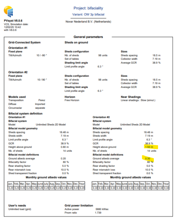

  4. Hi, I would like to calculate the bifacial gains of an EW solar park. I made a 3D shading scene. East west oriented. Height of 0.8m. for some reason the second orientation always uses the values height 1.5m and albedo 0.3. and i am not sure why. do i have a setting wrong? thanks in advance Age
  5. any answers/ updates on this topic, I also would like to know Peter
