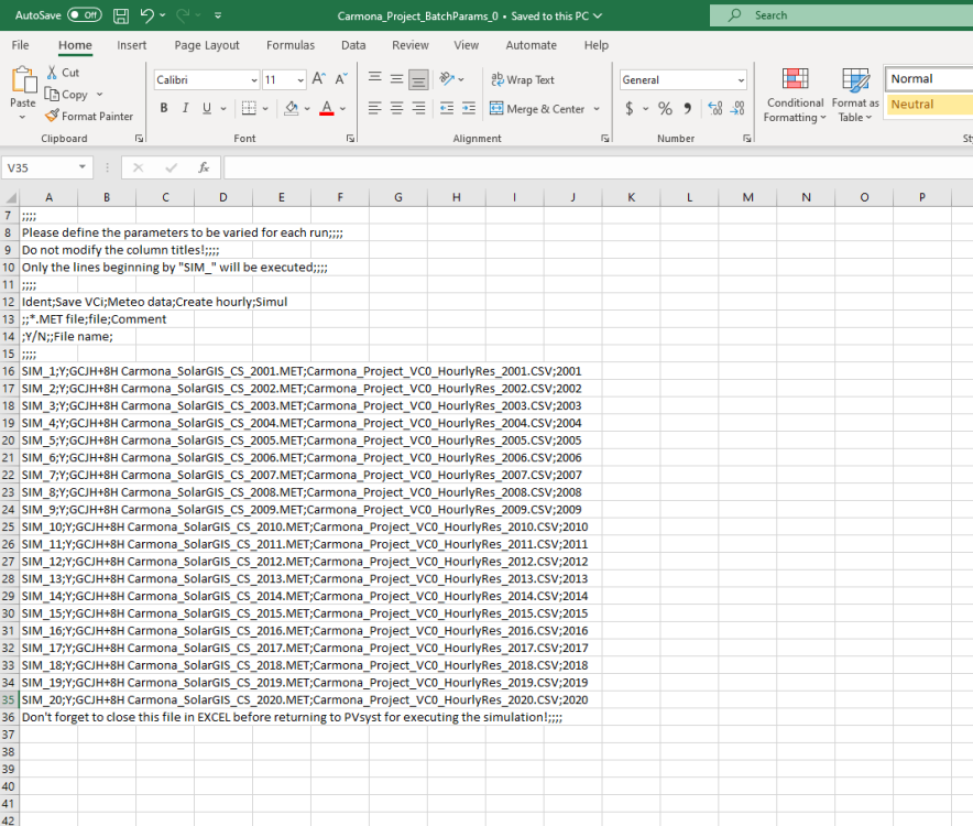

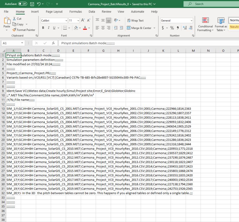

  3. Hi, I am trying to follow these same steps. I need to get 20 hourly production simulations by varying the meteo file I already have uploaded in the database. However, for some reason, the hourly production files are not showing up. Can you help me by giving me an example of how to vary the meteo file or tell me how to do it step by step, please? Parameters: Results: And there is nothing in the file of userhourly. Thank you so much in advance.
