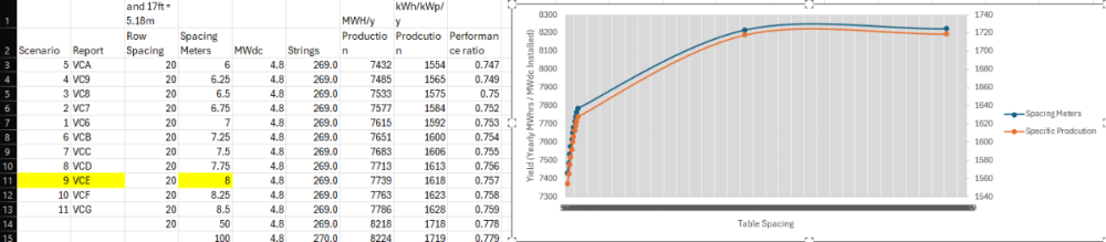

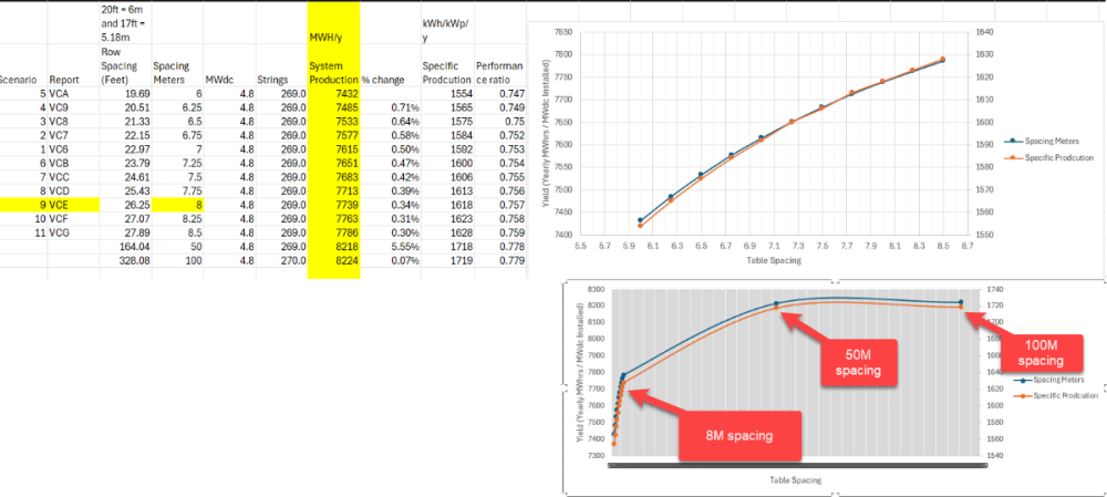

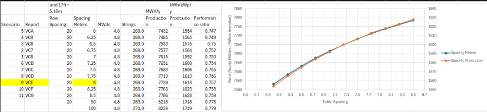

  1. I fully expected energy to plateau as you mention dtarin. Perhaps my variant comparison above was confusing- so I have added some annotations below to help better explain my concern. At 50M, there should be very minimal row-row shading with of course the exception in the early / late parts of the day. To your point, we should not see an appreciable yearly energy increase. This "plateau does not occur until roughly 50m. @Michele Oliosi I did add the suggested shading loss to the 8760 data and plotted in excel. I do not see a significant change here. I can share my model - can you suggest a method for file sharing?

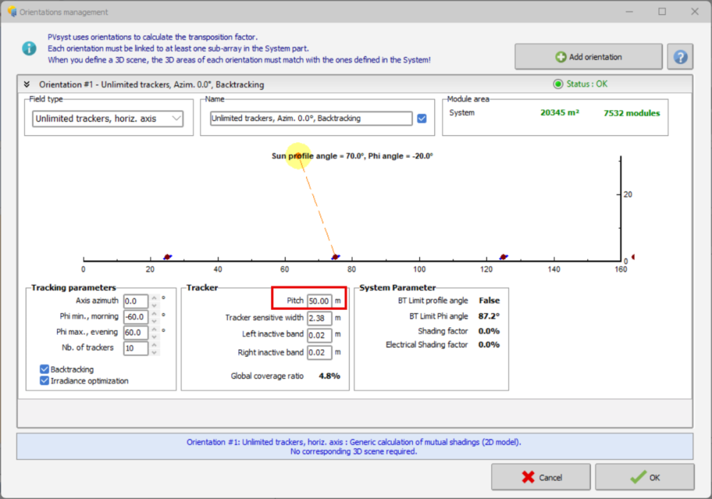

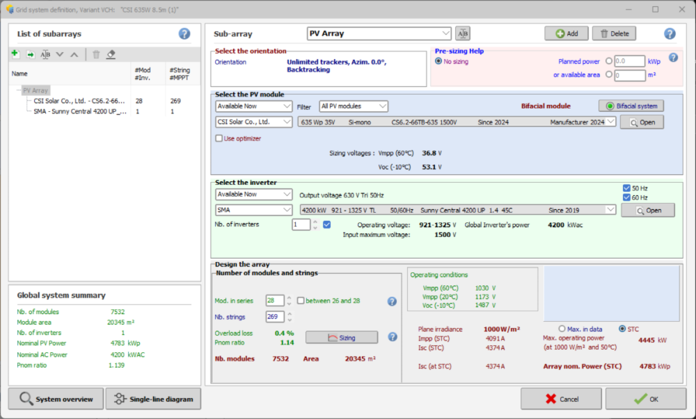

  2. Background: I built a simple single inverter model to investigate energy vs tracker row spacing. In all cases, I kept the array consistent and only increased the tracker spacing in increments of 0.25M. I expected to see that annual energy would plateau at some point and not increase, indicating the MAX optimum space. There is more to my analysis but, this is the background for the issue at hand. As I increased from 6 through 8.5 meters, energy continued to increase. I then jumped to 50 meters and the trend continued! Similarly, I used 100M and the results continued to climb. I have no HV transformer or other losses and the consistent system definition below:
