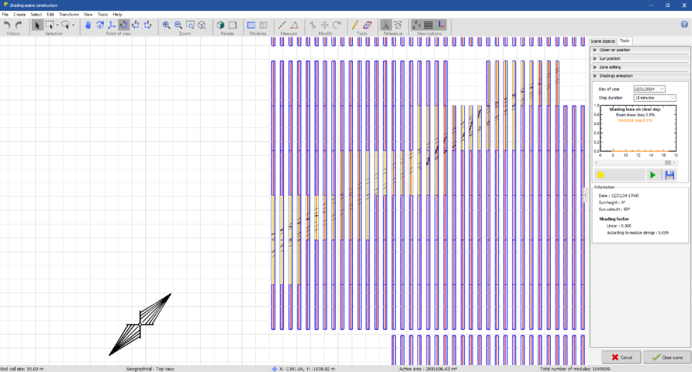

  1. Is this resolved I am also facing the same issue. Object shadings are being considered and the adjacent tracker shading is not being considered. is there any work around.

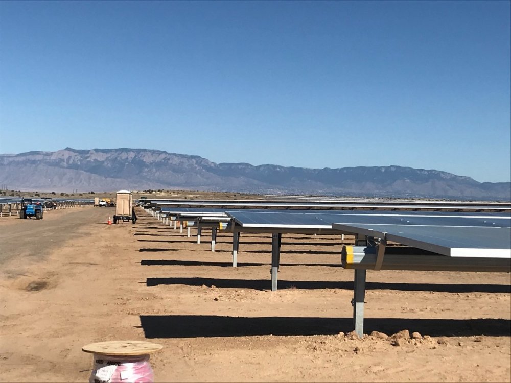

  3. Hi Team, In one our sites which had just completed the construction we are facing a peculiar problem. The site top of pile elevations have not been done perfectly by the EPC and we are trying to gauge the impact of the same on the shading. We have adjusted the Tracker table heights as per the As-Built of the site and tried to import in PVsyst. Initial simulations indicate that there is no change in the Shading losses (both near shading and electrical shading). However, we think that in 1 tracker table the North to South orientation may not be perfect and may have different orientations considering the site topography. Does PVsyst has a way to consider this point in to the simulations for understanding the shading losses. If you see in the image, you can find that the trackers are not following the slope of natural terrain and they are placed in a manner that 1 tracker is 12"higher and the other lower. Regards, Vamsee

  5. Hi Michele, If we change the axis tilt spread, we are getting very erratic results. Moreover, when we are using terrain following trackers we expect the tilt spread would not be even, the comparison is being done with far East tracker with far West tracker table which its expected to have this difference. Thats the sole reason we are doing the 3D shading to assess the impact on the EYA and electrical shading. Again, sometime even without changing this parameter the shading scene is running. Please can you look in to this issue.
