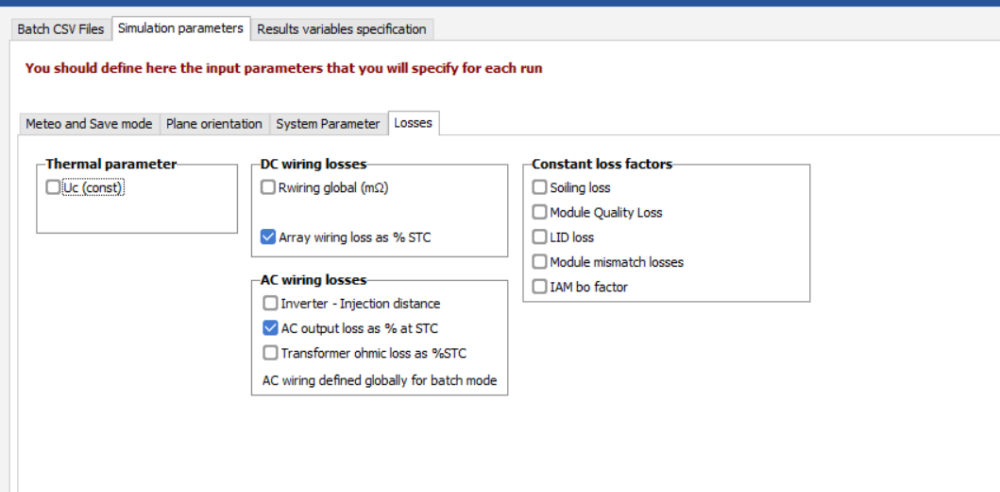

  3. I have been trying different layouts, where my string count and DC, LV, MV and HV losses are changing. I do not see the option to add MV and HV cablers as variables. is there a way to include them?

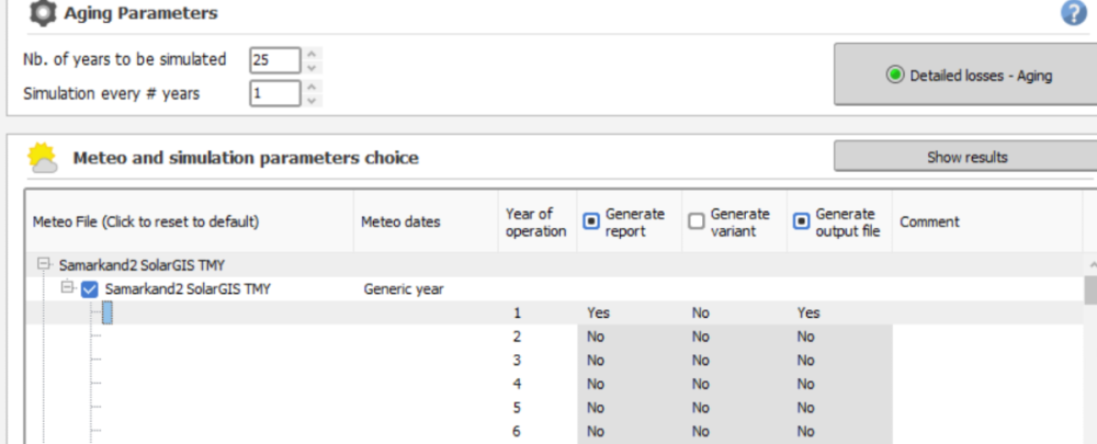

  4. I am running ageing simulation, i need to produce hourly files, for a few of the simulation years, but they are not produced. is that possible? i ticked the generate report and output file tabs, and i get a pdf report, but no hourly file.
