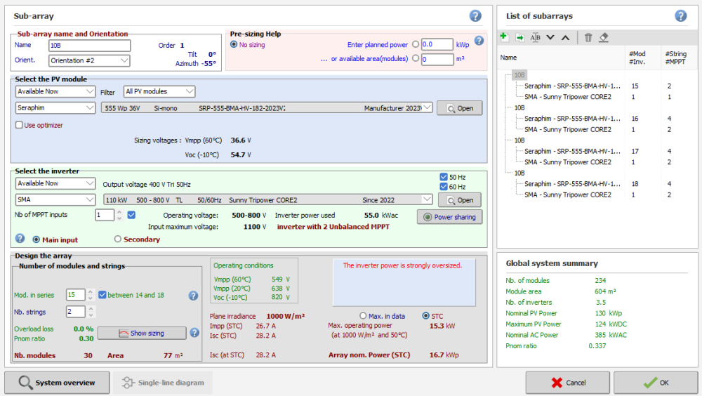

	I am studying to build a PV system of 555W panel installation on three different levels of building. However the PVsyst warned "strongly oversized" of inverter.
	G/F: 94 pcs of PV panel, is divided into 2 x 15 + 2 x 16 + 2 x 16
	4/F: 70 pcs of PV panel, is divided into 2 x 17 + 2 x 18
	R/F: 70 pcs of PV panel, is divided into 2 x 17 + 2 x 18
	Inverter Model: SMA Tripower Core 2 is available with 12 independent MPPT (2 strings per MPPT) (https://files.sma.de/downloads/STP110-60-AFCI-DS-en-20.pdf)
	PV Panel Model: 555W Seraphim (https://www.seraphim-energy.com/wp-content/uploads/download/SRP-(540-555)-BMA-HV_182_EN.pdf)
	Is there any setting wrong I did?
