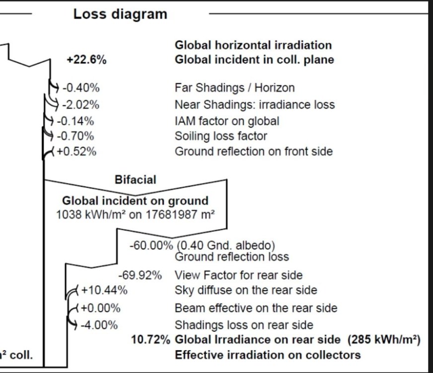

Hello, Thank you in advance. My I know how the global irradiance on the rear side is calculated 10.72%(285Kwh/m2) considering the the site irradiance was 2229KWh/m2.

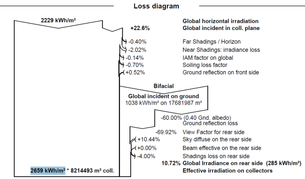

i am using manual calculation to get the PR value and when i compare it with the software it was not matching so i just need you kind explanation about how the PR is calculated in the software to find the difference reasons. or you could please clarify why there is a difference between the below methods cases: 1. Irradinace is 2229 KWh/m2 2. Appling the losses over the irradiance ( 2229* (100%+22.6%)*(100%-0.4%)*(100%-2.02%)*(100%-0.14)*(100%-0.7%)*(100%+0.52%)*(100%+10.72%)=2534.68KWh/m2) 3. looking to the software here in the below attachment it is coming = 2659 kWh/m².
