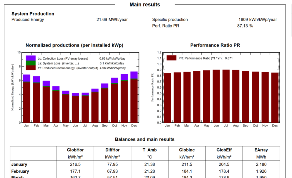

  7. I have just updated my PVsyst and noticed that in the “Main results” page, there is no longer a column for “Egrid” and “PR”. Is this a new feature or is this a bug? How can I view my monthly “Egrid”
