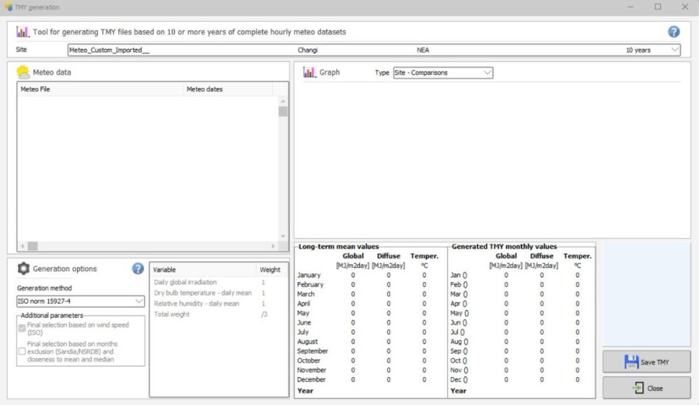

  4. Hi Michelle, Thanks for the clarification. I managed to generate 10 separate MET files from the raw data but was unable to generate TMY using the ten MET files. I am not sure why.
