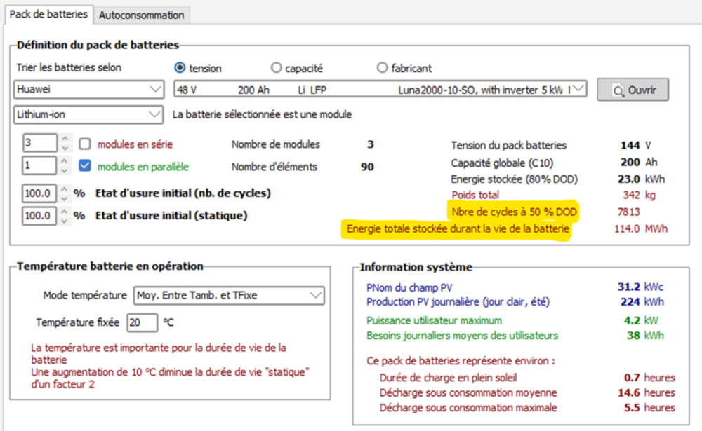

  1. 1. So in PVSyst the estimated number of cycles at 50% Dod, corresponds to the number of cycles (at 50% DoD) possible before the battery capacity goes from 100% capacity to the guaranteed capacity (80% or 70% in general), right? 2. So the Sankey Diagram correspond to the average kWh stored annually by the battery the first year of use, right? The self-consumption estimated in the Sankey would therefore be the most optimistic situation (year0). To make a correct profitability calculation over the battery lifetime, we would have to admit a decrease in this self-consumption rate over time, right? To take this effect in the profitability, we have to do another PVSyst variant with a battery with a nominal capacity of 70%-80% DoD of the first battery AND taking the average stored energy of the 2 batteries? Could it be a good approximation? Thank you. and have a good day, Sylvain Vitali
  2. Thank you for your feedback, So in PVSyst the estimated number of cycles at 50% Dod, corresponds to the number of cycles (at 50% DoD) possible before the battery capacity goes from 100% capacity to 80% capacity, Right?Also, the estimated total energy corresponds to the total energy stored until the battery reaches 80% capacity? Isn't it a bit of a shame to assume that the battery is no longer usable when its capacity drops below 80% or 70%? Couldn't we define in PVSyst that the battery is discarded when capacity is reduced to 50% or less? Furthermore, does the value given in the Sankey Diagram correspond to the average kWh stored annually by the battery (with a capacity varying from 100% to 80% during its lifetime), or does it correspond to the state with a new battery (100% capacity), i.e. roughly to the first year of use only?
  3. Hello, PVSyst automatically gives the total amount of energy stored in a battery during its life, which is very interesting (it would be even better with the latest Huawei Luna battery models). How is battery life defined? In the example below, can I assume that after 114 MWh, the battery is completely dead? And are these kWh estimated on the AC side of the battery's inverter, taking into account the inverter's efficiency? Thanks in advance for your help, Sylvain Vitali

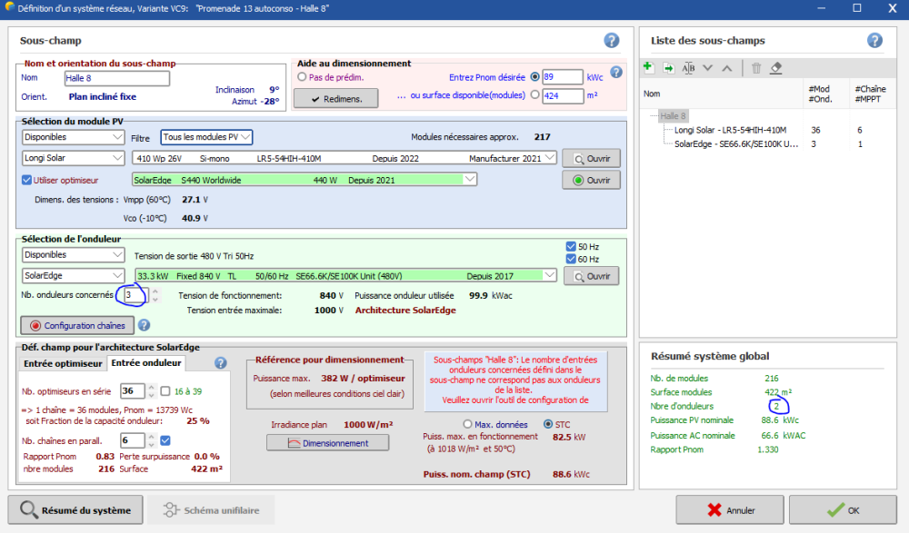

  6. Hello, As part of a PV project with an 89 kWp optimizer, I'd like to study the difference in production between a solution with 2x33.3 kW inverters (SE66.6K) versus 3x33.3 kW inverters (which is currently ordered). But I don't manage to simulate the production with 3x33.3 kW inverters. PVSyst don't let me oversize the installation, but it will be done in reality... So that's important that i get this simulation in order to prove that 2 inverters is better than 3. I note that I don't have the option of adding an inverter manually in the string configuration, as specified in the help file. Nor limiting the number of strings solutionate the problem: Thank you for your help, Sylvain Vitali
