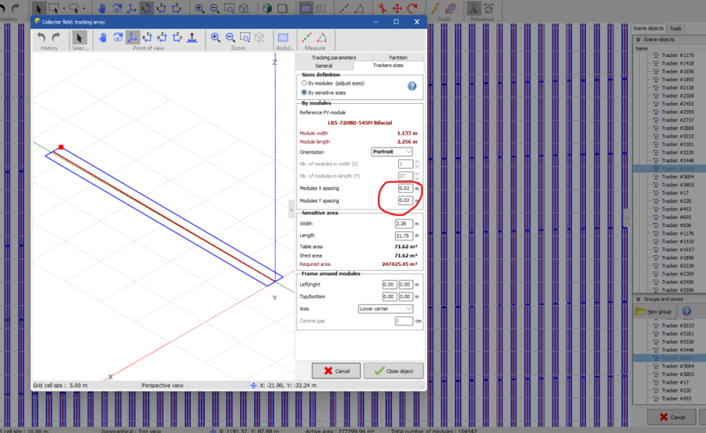

  1. I have a 3D scene that I created by importing a *.PVC file from PVcase. When exporting from PVcase, the motor gaps in the tracker is taken as module area by Pvsyst and so I have more modules in the 3D scene than what it should be. I tried to adjust the module gaps to lower the number of modules but couldn't do it for all trackers at once. Is there a way for me to make this modfication for all the trackers at one go? This is a 50MW+ system and I have about 3,900 trackers and it will take a lot of time to adjust this individually. I have attached a screenshot to show exactly what parameter I'm trying to modify. The parameter is red-circled.
