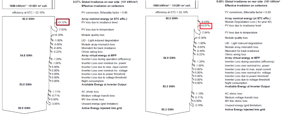

PV loss due to irradiance level changes when changing the module degradation loss
gpuy replied to gpuy's topic in Simulations
I´ve realised the problem happens only with PAN files provided by manufacturers (no default checkboxes checked), and it doesn´t happen with PAN files from the database. Thank you very much for your support, Michele. Regards, Guillermo. -
Thanks for your answer. How could I check if the module I´m using has standard one-diode parameters? -
Sorry, I attached screenshots from 2 different projects. But I assure you that´s not the problem as you will see: -
With certain modules, the PV loss due to irradiance level changes when changing the module degradation loss. This only happens when the module degradation loss is changed from 0% to 0.4% but it doesn´t happen for changes from 0.4% to bigger values. But since the PV loss due to irradiance level stands for the low module efficiency with low irradiances... shouldn´t it remain constant?
