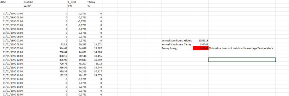

  3. i did sum of annual values of Globinc and for Tarray then i did Globinc time Tarray over Globinc and i found 136543 this last does not match with annual averrage temperature
  4. i have one question concerning how I can calculate Weather corrected PR: TArrayAverg:sumHours(Globinc*Tarry)/sumHours(Globinc) please can you clarify for me this issues because i generate hourly values of Globinc and Tarry and i accomplish sum of annual value of two variables therefore through the calculation of TArrayAverg I found values does not make sense does I miss some details about this equation
