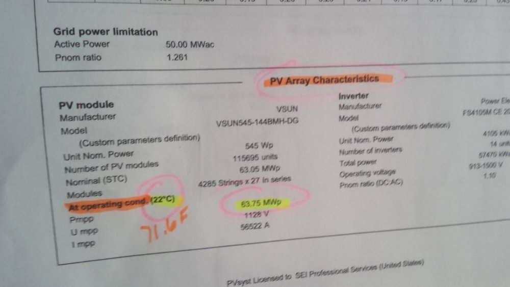

  7. Thank you for the response. "It does not affect the simulation per se." That is not a definite "no." If the module is hot, will not be less productive? For example; if we used 50C, that would not affect the simulation compared to the 22C? Thank you again
  8. Hello, I am wondering if the AT OPERATION CONDITION under PV Array Characteristics has any impact on production with different temperatures? I have spoken to a few different colleagues and have received many different answers. Please see attached. Thank you
