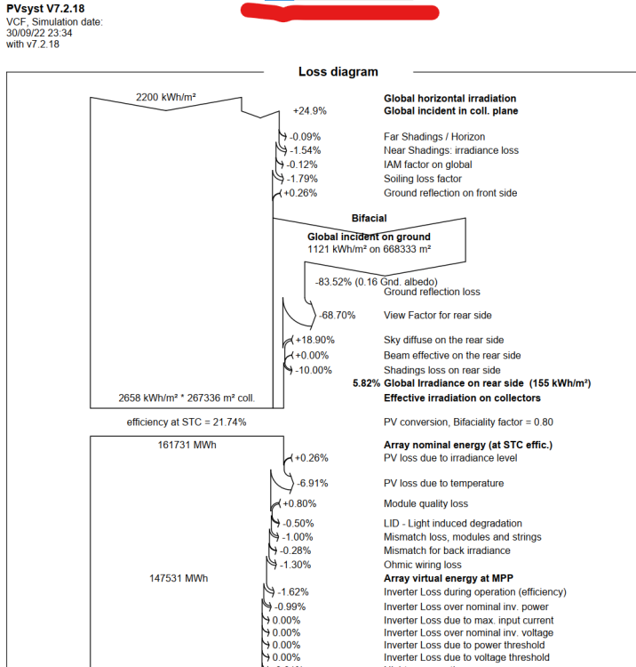

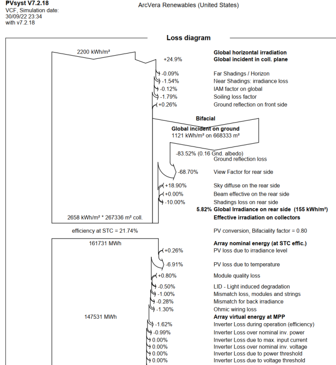

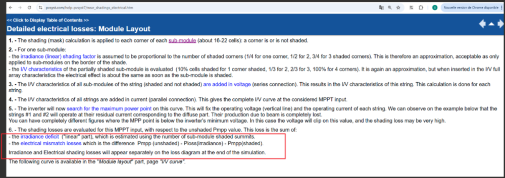

  1. Dear @LL , Since which version of PVsyst it is presented in the report the correspondent electrical mismatch losses? Our doubt is why it is not presented in an report from version 7.2.18 and since it made available by the tool. Below some pictures to better ilustrate the question. Thanks in advance! Report that is raising the doubt: Desired report (example):
