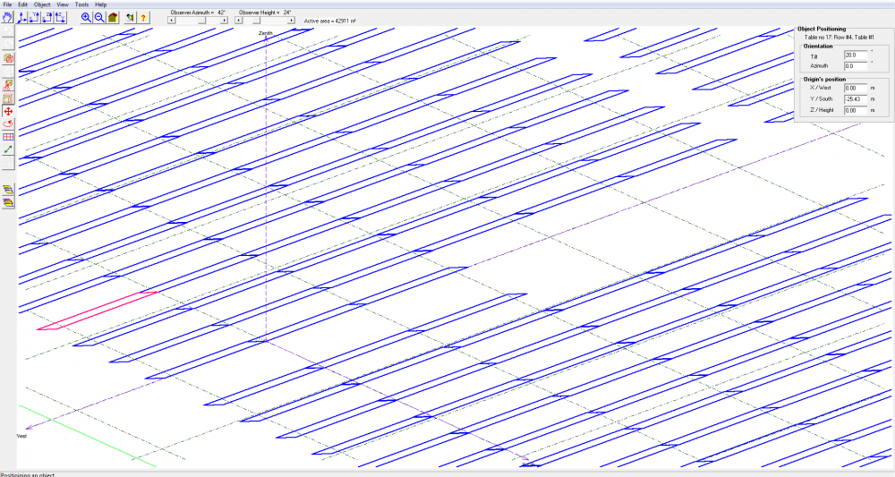

  1. Good afternoon I’ve updated PVsyst to v6.70 but this error is still there. I've noticed why PVsysts always assumes Pitch (Sheds spacing in 6.7) 5m in the report when you import a layout from Helios3d. When you go to construction perspective and open a single table that you imported from helios3d the default values for pitch is 5m. But this is wrong in the full layout we have different pitch so is there any way to remove this option from the report or fix it? Thank you for your support

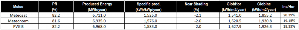

  7. Good afternoon I'm comparing 3 different Meteo databases and in this 3 simulations i used all parameters losses modules inverters are the same just changed the Meteo, I get the following results: I don’t understand why Meteonorm VS PVgis have almost the same Global Radiation and the PR changes so much (81.6 - 82.2)? and Meteonorm VS Meteosat have the same difference on PR (81.6 - 82.2), with lower radiation and higher GlobINC i have more gain in (Hor / Inc) that i understand Is there some other parameter that affects this when using different Meteo files? Thank you for your support

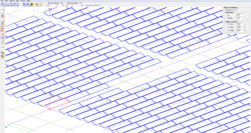

  9. Hello I had to come back at this Post because, We are trying to find out how the azimute was calculated when we have multiple orientations and we had to use higher "Discriminating orient. difference between shading planes", we did several tests the azimuth it show's on the image bellow: Is the azimut of the "Main Table" the one that we creat first or in cause of Helios 3D it alwas show the same azimuth in "constraction prespective" im assuming it is average? or is it the azimute of the "main table"? We are now doing a project with very hight slopes what's the best since PVsyst "during the simulation, the incident irradiance will be calculated once for the average orientation, and applied to all tables in the same way, resulting in a (little) orientation loss." We wanted to know how should we treat this case? Should we add some losses to consider this "orientation loss."?

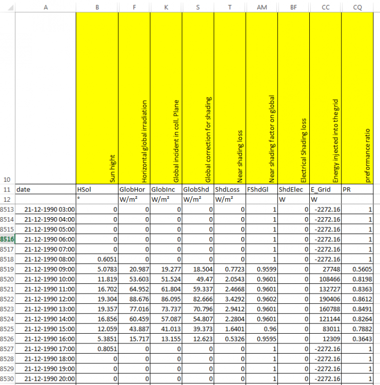

  15. Hello I’m sorry for the spam I found that for Horizontal Beam there are some values missing or low values a lot actually, Maybe this could be the reason why I’m getting this For this test I’m using another Meteo file from PVGIS On the first Post I was getting BeamHor = 0 in every cell for 21-December, but now even with this one from PVGIS there are some missing values. In the images bellow the red/green cells corresponds to the acceptable / unacceptable values for BeamHor Blue Cells were calculated: (ShdLoss / GlobInc.) to have a perception of the loss % In this table we can see that there are some missing values and low values that doesn't make sense more losses at the mid of the day then at morning I found this one acceptable at least make more sense than the other two This one seems good too more losses at morning/afternoon and less on mid-day It was harder to find correct values then wrong / missing values. 1- Could you see if this is a bug from the program it fails to generate some values or something? 2- The program calculates the shadows for every hour with the corresponding shading factor but it needs the beam Irradiation right? Thank you in advance for your support

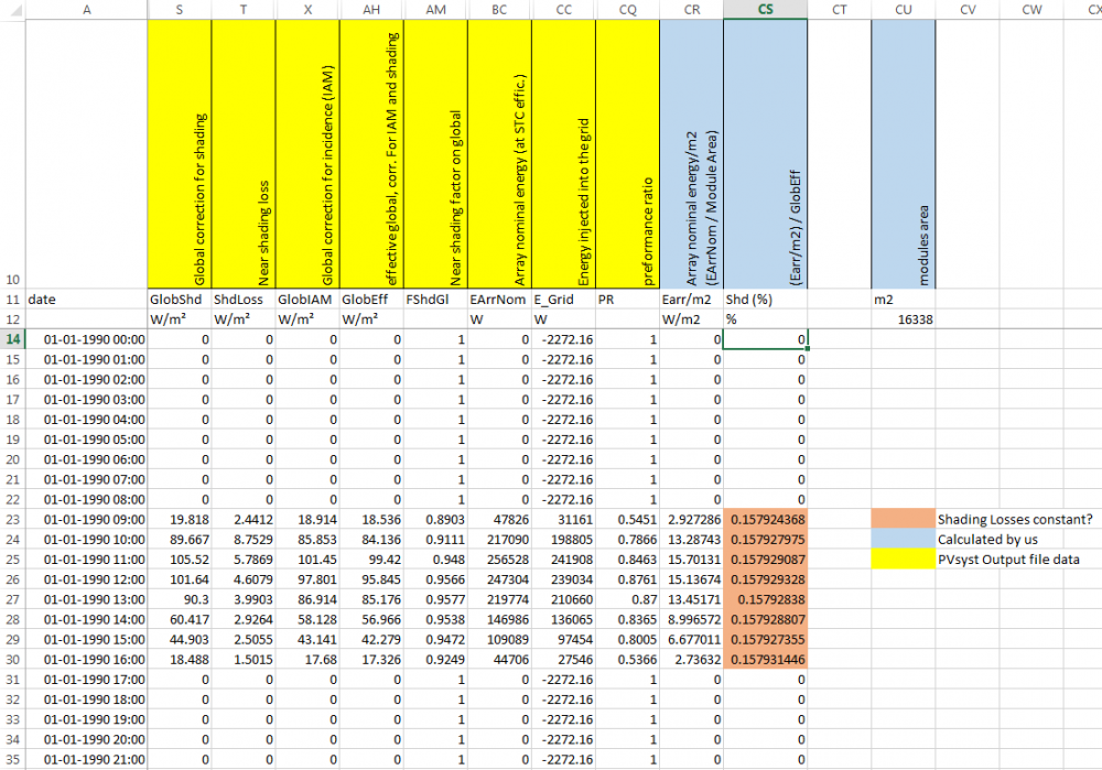

  16. I was analysing the output file tables and for what i understand PVsyst is taking the shading loss constant for all the hours So PVsyst just uses the Near shading Table and shading factors to calculate 1 final Shading loss that is used constant in every hour? Shouldn't it use the shading factores that it calculates in the near shading table to get the values for GlobEff / EARRay etc... correctly for every hour?

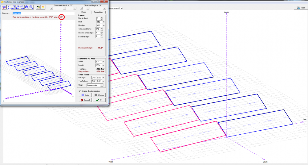

  23. Hello I have to make an simulation with PVsyst 6 near Dubai latitude 24° and when i import the plant from Helios to the near shading Construction / Prespective the tables are facing North when they should be facing south and it asks me for an tilt angle of 160º If i use the same file on PVsyst 5 it gives me the correct tilt angle 20º south I checked everything on helios is correct and it is ok in PVsyst 5 Is anything i have to take in to account in PVsyst 6? Can this be fixed? Thank you for your support
  24. Hello In PVsyst 5 we could control the "Shading max. orientation difference between shading plans" on the hidden parameters so you could simulate even if the difference was too big (bad terrain) Now in PVsyst 6 I can’t find an parameter where I can define the nº of orientations (see image attached) Is there any parameter to define this limitation? So PVsyst could make an “average” of the orientations? Thank you for your support.
