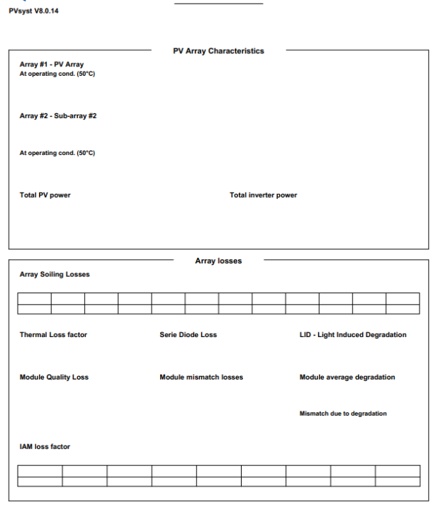

Hi all, my colleagues and i are having errors when printing reports in the newest update. .14. the reports are either blank or the loss diagram is jumbled.

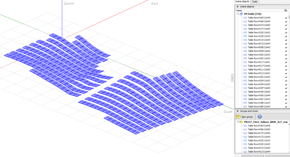

Trackers not following topography
solarDG1470 replied to solarDG1470's topic in Shadings and tracking
is the solution to "ungroup" the array and then set altitude per individual row? -
Hi all. i have imported topo data and generated this shade scene of trackers. when i click "set auto altitude" at the highest point, the trackers do not properly follow the slope/topography. how can i fix this? less important question - the area with the highlighted streaks is always white space and i can only see the shade scene on the bottom left of my screen. why is that??

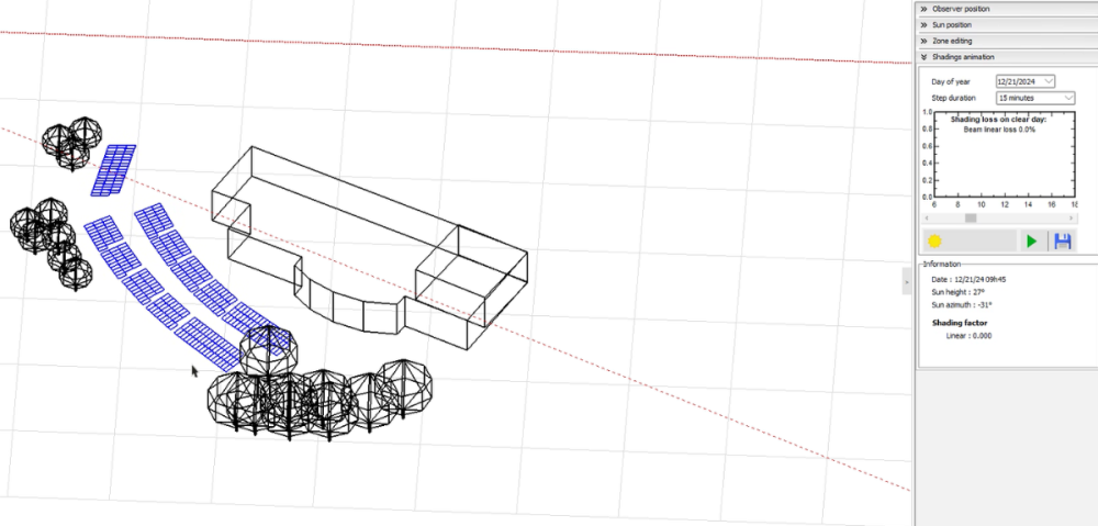

hi, i am having issues with near shading scenes in 8.0.5. the shade is not being calculated at all. 0%. we put a tree adjacent to the carports and it is still reading 0% near shading loss. a few iterations before, we were getting the near shading to work. we tried the same project on 2 separate computers. This has happened on a couple other projects this week. see photos below. thanks!

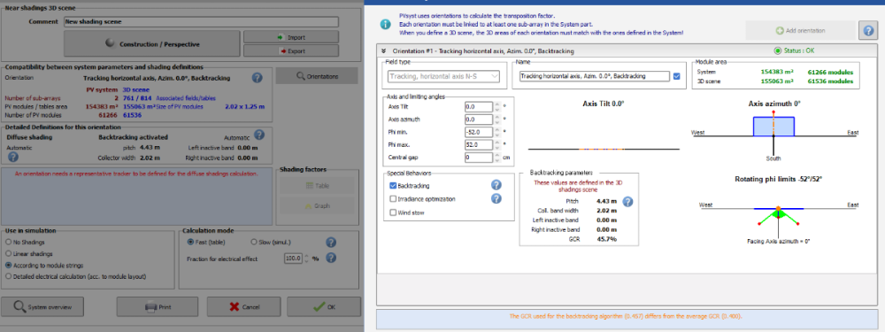

we are getting this on projects that were setup in version 7 but now being simulated in 8.0. can anyone help with this issue? we cannot run any simulations with 3D scene. "an orientation needs a representative tracker to be defined for the diffuse shadings calculation"

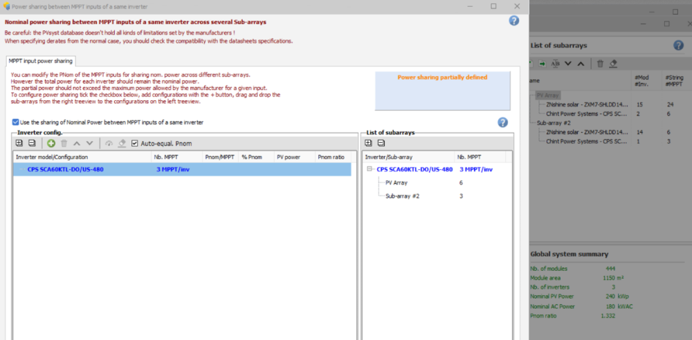

I have an issue with MPPT power sharing. each inverter has 3 MPPT inputs. there are 3 inverters total and the MPPT breakdown is this for all 3: CHINT CPS SCA60KTL-DO/US-480V MPPT #1 = 4 strings of 15 mods per string (540W module) MPPT #2 = 4 strings of 15 mods per string (540W module) MPPT #3 = 2 strings of 14 modules per string (540W module) Remember there are 3 total inverters so I have a total of: 24 strings of 15 mods per string 6 strings of 14 mods per string PVsyst is not letting me power share correctly. it is not giving me the option. I have experience with power sharing in the past, but i cant get to the screen that lets you move around the strings on each inverter. Thanks for your help!
