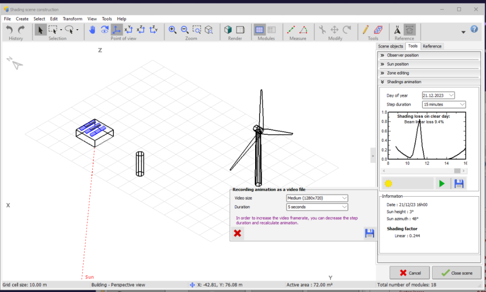

Test.avi Hi there, the 3D shading simulation works, but the recording animation as a video file has some problem. Only the first time the recording records the moving of Sun, the rest recodings didnt record the moving, as attached video. All video sizes and durations are tried. Kind regards

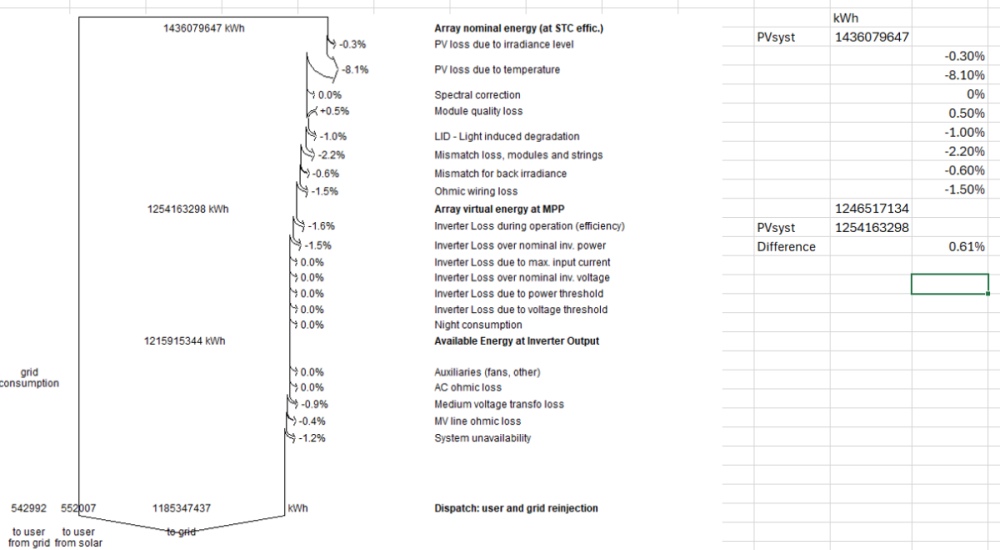

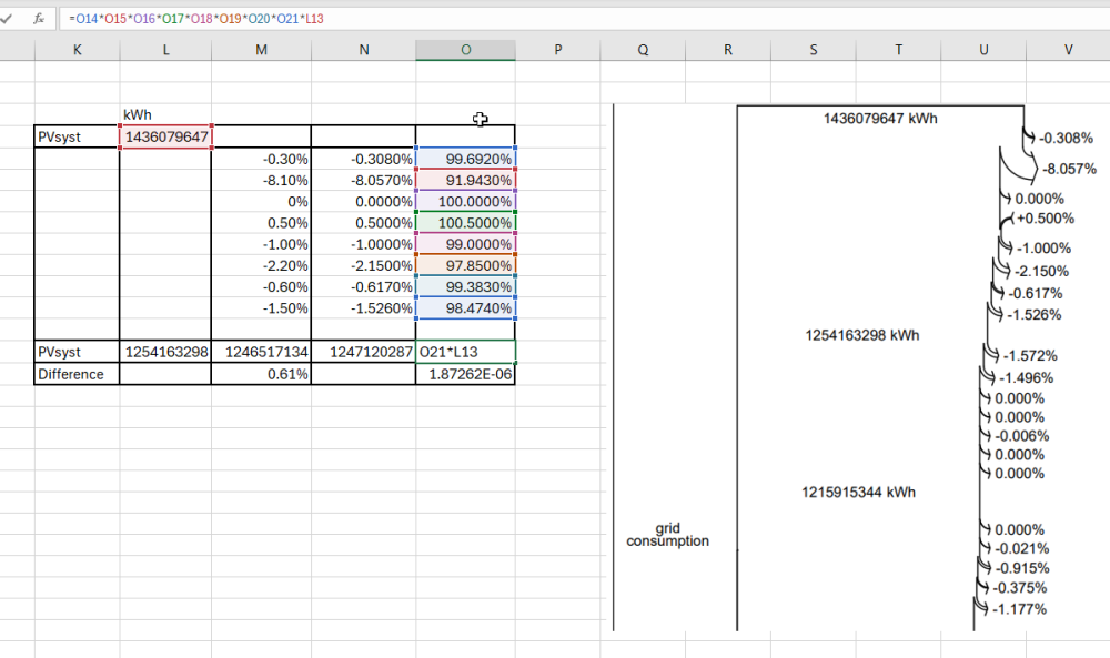

Effective Energy at output of array doesn't match sum of losses
Li-ESS replied to nico7904's topic in Simulations
the latest try for your reference, this a grid connected system. The difference is about 0.61%. Please correct me, if any thing wrong in the process. PVsyst Version 7.4.8 -
