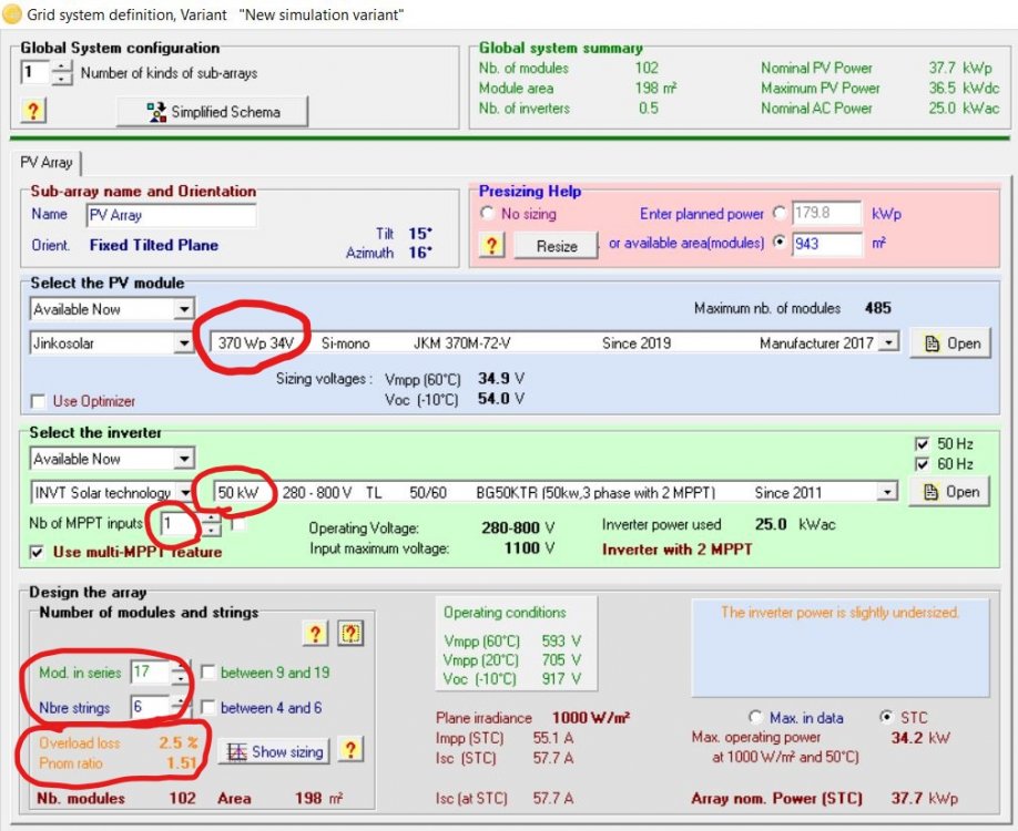

  1. I use the solar panel "Jinkosolar 370W" and inverter "INVT 50kW with 1MPPT" The design layout consist of 17 panels connecting in series and 6 strings, which result to total panel of 102 panels. The expected total power output should equal to 37 kW ( total power = 370*17*6 ) However the result of PVsyst shows the "Overload loss" notification. My Questions are: 1: Why is there overload loss notification in the PVsyst software(I think that the power output 37kW is still below the selected inverter of 50kW)? 2: When I increase the MPPT number, why the overload loss also reduce? This photo represent the design project
