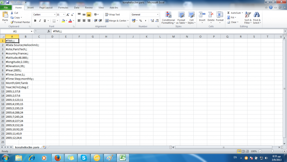

Hello, I am a new to PVsyst 6, I have just download the free trial version for my internship, but I have a problem with my meteo data.I have used the SoDA and I choose the Helioclim3 (monthly values) for the 2005 but I can not change it to the standard PVsyst file. They are monthly values and they do not include wind speed or Temperature, is that a problem? Which are the necessary input data for this form? Thank you in advance for your response.
