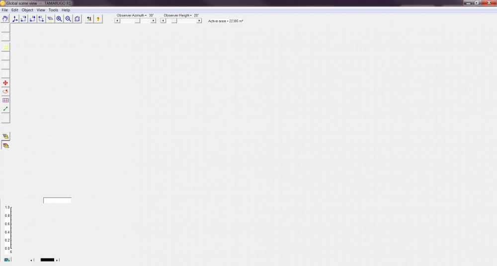

xavier.pastor Posted December 10, 2014 Posted December 10, 2014 THE SHADING ANIMATION OPTIONS DOES NOT WORKWhen starting the animation, the screen keps as the screen shot attached until the simulation ends. Its imposible to see the animation, only the first and the final frame.The models are brand new, not imported or reused from old versions.CONFIGURATION:PVsyst 6.32 PREMIUM, but is being produced in any V6. It not happens with old V5.SYSTEM: Windows 7 Professional SP1PC: i7 quad core with 8 GB ram and 1TB discGraphics: integrated intel 4000 chipset and NVIDIA GEFORCE GTXThe use of the integrated graphics or the NVIDIA can be selected by user, but in any case doesn't work.Please provide a solution.ThanksScreen shot of an animation
André Mermoud Posted December 11, 2014 Posted December 11, 2014 I have never got nor seen this problem.Please send me your shading scene *.SHD (using "File" / "Save scene" in the menu of the 3D editor).
