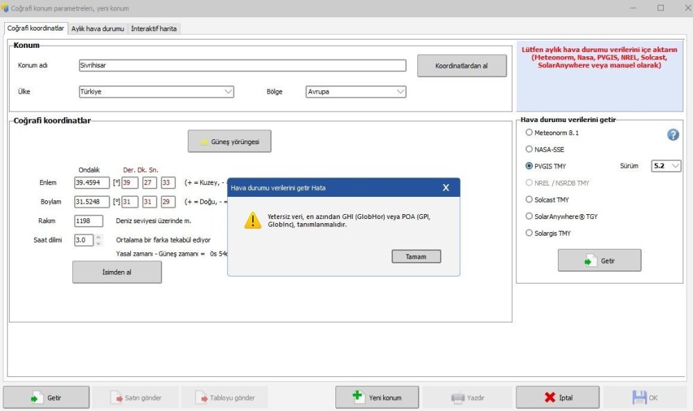

Hakan Öztürk Posted April 22, 2025 Posted April 22, 2025 PVGIS TMY butonunu seçip getir diyince bu hatayla karşılaşıyorum. Bu sorun hakkında yardımcı olabilir misiniz?
Linda Thoren Posted April 22, 2025 Posted April 22, 2025 Hello Hakan öztürk, Please note that this forum is in English. In December, PVGIS modified their format for the TMY output, which has affected the functionality of our API. The data reading was updated in version 8.0.6. Please update to a more reason PVsyst version and this should solve your issue.
