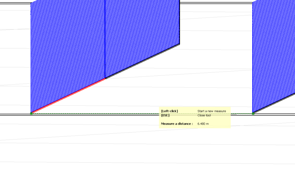

terenceaijei Posted April 22, 2025 Posted April 22, 2025 The sheds spacing from the the report is different from the dae file that I imported in near shading scene which I have attached in this email. Imported dae file is from sketchup and solar panel are generated by skelion.
Muhammed Sarikaya Posted April 22, 2025 Posted April 22, 2025 Dear Terence, Is it possible to send us the DAE file to "support@pvsyst.com" so we can also try it and check why there's a difference between the near shading and the report? Regards
