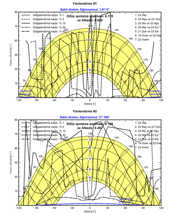

Bahattin Posted December 5, 2024 Posted December 5, 2024 I am currently working on a Project. At this point, I am getting the wrong Simulation results of the Shading diagram and production scenarios. As can be seen in the photos I uploaded, the shading loss lines in the azimuth diagrams move differently. I would appreciate if you can return quickly for this problem.
Michele Oliosi Posted December 5, 2024 Posted December 5, 2024 @Bahattin Did you try to click on “Recompute” in Near shadings > Table ? This may fix the issue. Do you have more information on how you built your scene, and what were your detailed steps (regarding shading parameters) up to the simulation ?
