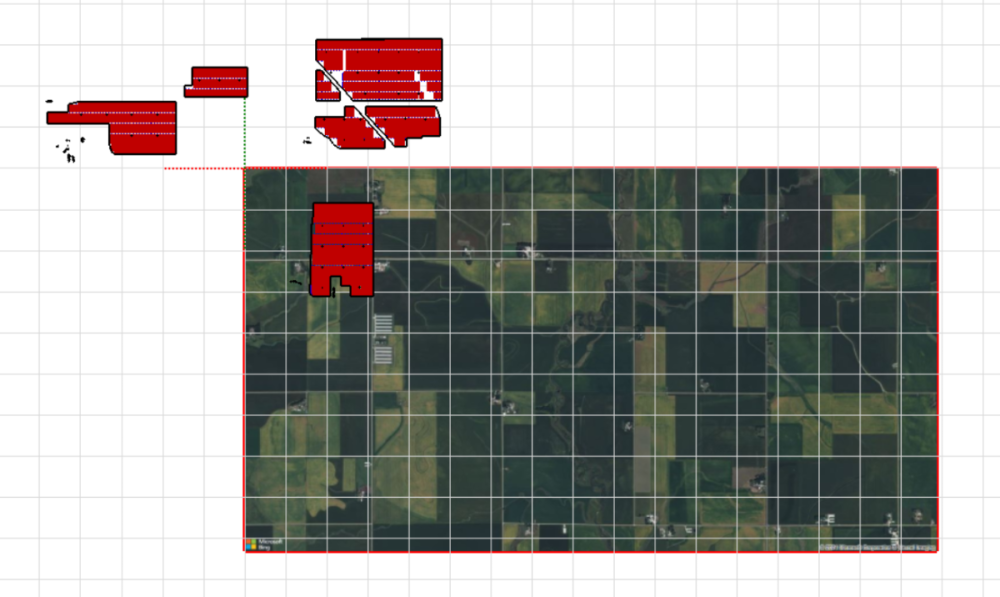

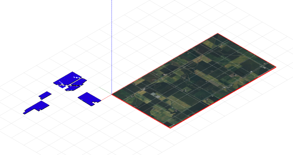

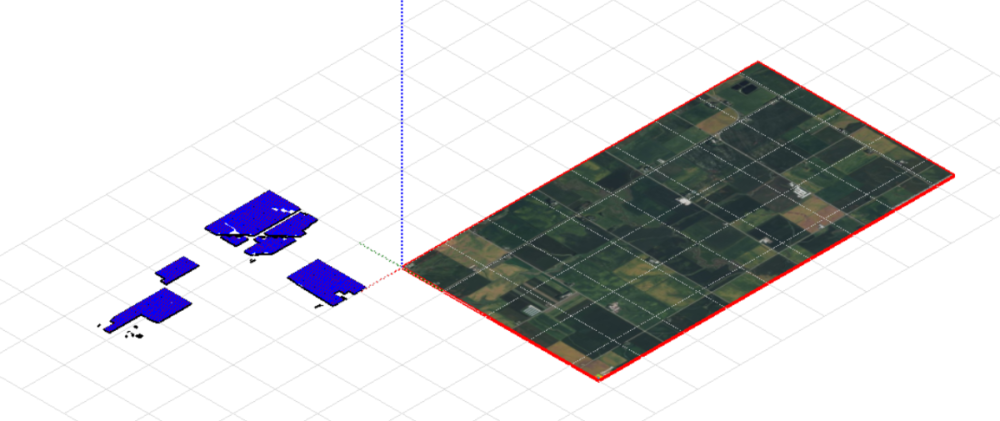

Joe Hollingsworth Posted November 19, 2024 Author Posted November 19, 2024 Okay, I added some tree lines, and when I used 0,0,0, for the translation this is what came up. When I apply the automatic translation, this is what happens: Does this have something to do with the geogrpahical site location? It seems that the interactive map that pops up to download does not allow me to go to the aerial location of the project. I'm not sure if this has to do with a lat/long of the geographic location or when inserting the image. Let me know if you have any suggestions, and thank you as always @dtarin.
dtarin Posted November 19, 2024 Posted November 19, 2024 Manually move the modules and objects over the image and line things up that way
navdeep4solar Posted April 4 Posted April 4 After Inserting the image, Just click on Modify button and move your image underneath the modules, Its just a click away.
