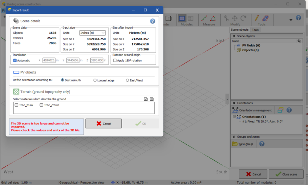

Isaiah O Posted Wednesday at 05:26 PM Posted Wednesday at 05:26 PM When importing a PVC file into the shade scene using PVcase, are there specific size limitations that could cause issues with larger projects? I am encountering errors that indicate the project is too big, likely because the file size exceeds the program's processing capacity. When I downsize the project, it functions normally. I would like to know the exact size limit that triggers the "too large" notification. For example, does the notification activate when the PVC file exceeds 2,500 KB? I have seen other forums regrading this and those other solutions does not apply to this situations at hand.
Stéphane Posted yesterday at 03:35 PM Posted yesterday at 03:35 PM There are mainly two reasons that can lead to this error message: The unit selected at the top of the screen is not correct There is a "lost" object really far from the origin of the scene Looking at the size after import at the top right of the screen, 212km and 175km seem way to high for a scene. The reason is likely the second one. Locate this "lost" object in the source software, delete it and export the file again. It should import properly into PVsyst.
