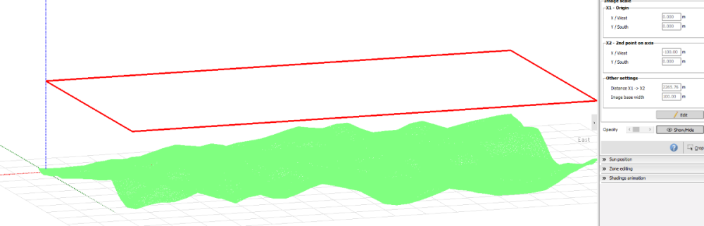

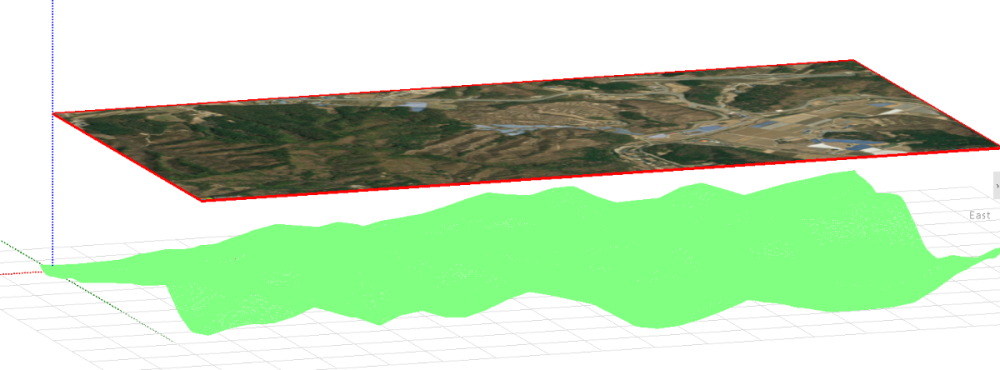

Swonno Posted Wednesday at 01:30 AM Posted Wednesday at 01:30 AM (edited) I clicked show/hide option but it just become white and can't see terrain in the top view. What if i have many images and want to match many images together ? i.e. one is PVsyst terrain image and another one is Autocad 2d batch image? Because I mostly receive 2d pv module batch. How can i use terrain with 2d batch image together? Because it is not only a problem of show/hide image but also when i can only see one object of terrain or one image becasue the image hide terrain or terrain hide image. and , I don't precisely know where is the our project site only in PVSyst terrain image. I need some more extra image to refer to know the our project site. Pls guide me. Thanks Edited Wednesday at 01:31 AM by Swonno
Stéphane Posted yesterday at 03:23 PM Posted yesterday at 03:23 PM Hello. Hiding a ground image makes it white instead of transparent, that's why it is hiding the objects behind it. This is a bug that will be fixed in an upcoming version of PVsyst. Thank you for pointing it out and sorry for the inconvenience. Also, if you prefer using ground images from external softwares, you can delete the one that PVsyst downloads through the interactive map and use external ones only.
