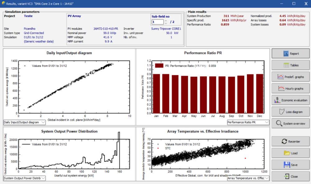

Bernardo-SUNSEI Posted Tuesday at 03:31 PM Posted Tuesday at 03:31 PM Hello! I'm having a problem with the new PVsyst 8.0 version: I can't generate reports. When I click on the "Report" button, the software freezes, and I have to force it to shut down.
Nils Lang Posted Tuesday at 03:39 PM Posted Tuesday at 03:39 PM Dear Bernardo, Most probably the crash you reported is caused by your computer graphic card’s driver. Please update your graphic card driver by following the procedure documented in our FAQ: https://forum.pvsyst.com/topic/1253-updating-your-graphics-card-driver-pvsyst-660-and-above/?do=findComment&comment=3402 Alternatively, you can try to run PVsyst with another graphic card driver of your PC if it has one. This selection is available in Windows settings (in Graphics settings) after you have chosen PVsyst program file: I hope this will help you to resolve this issue. Best regards.
