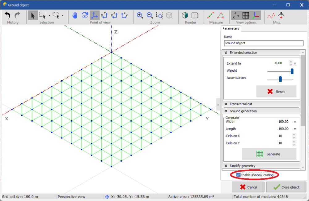

Daniela Silva Posted October 29, 2024 Posted October 29, 2024 Hello, Can anyone tell me if it is possible to do a 3D simulation with trackers, taking into account the shading generated by an uneven terrain. How can I do this? Can I upload contour lines or do I have to give coordinates of each tracker? Thanks.
Jéremie Bernier Posted November 26, 2024 Posted November 26, 2024 Hello, if you have a ground in your scene, edit it and make sure the box 'Enable shadow casting' is checked
