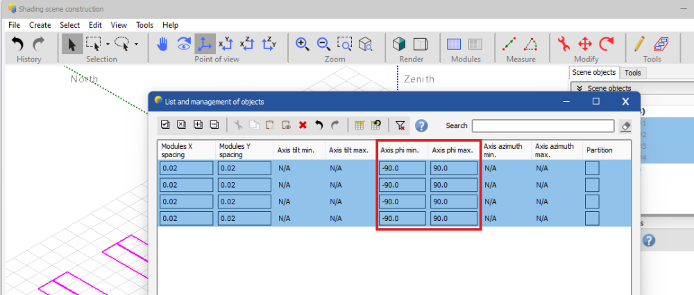

I'm experiencing this errors. I'm using Zone > Create tracking fields in the nearshading using a csv file.
This rectangle has 4 strings and a half cut module. Kindly advise
There is a problem with the trackers created by zones. These end up having +-90° of maximum and minimum rotation angles.
To correct this, once you created all trackers, you can either go to Tools > List and management of objects, or simply press CTRL+G in the 3D scene. There, you can find the column with the min / max phi and edit them to be compatible with the orientation.
Yup that solved it. Thanks Michelle.
