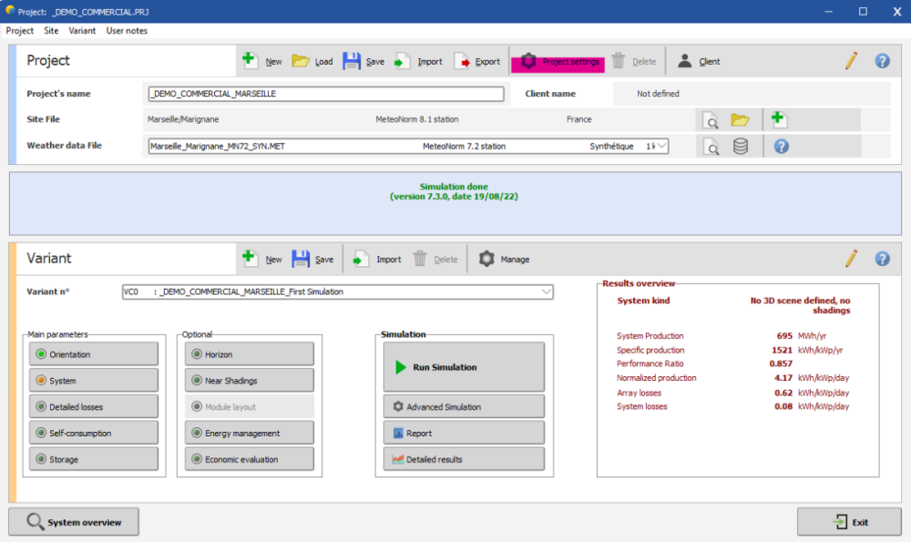

Click in "Project settings"
Then modify this value:
Please don't hesitate to reach out if you need further assistance.
