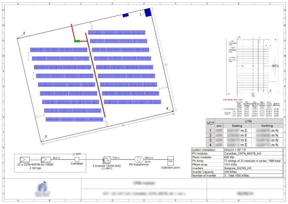

reza moayedi Posted August 6, 2024 Posted August 6, 2024 It is necessary to determine the position of the modules in the solar power plant. It would be great if we could get an output similar to the one below from the PVSYST software
Linda Thoren Posted August 7, 2024 Posted August 7, 2024 Dear Reza, By "position of the modules", do you mean the location of the installation? The simulation output is based on metrological data that will differs significantly depending on the location. Thus it is not the location per se that is necessary but hourly values of the position of the sun, the irradiance, temperature etc. If you refer to how the tables a placed compare to each other, this can be done in the Near shading and the scene can be saved and exported an image. Kind regards
