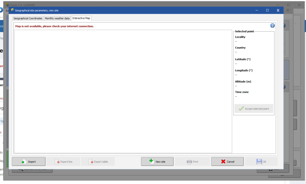

Nikoloz Posted July 11 Share Posted July 11 Hello Today all day long I have problems with new projects. When I try to add new geographical site parameters PVsyst gets stuck and dose not respond. it says " Map is not available, please check your internet connection. But it is ok with my internet. Please help. Link to comment Share on other sites More sharing options...
Nils Lang Posted July 11 Share Posted July 11 Dear Nikoloz, PVsyst is using a third-party web service to provide the interactive map: www.openstreetmap.org But since this morning, this service is either not responding or responding very slowly. Until now, we have not received information about when it will come back to normal operation. In the meantime, you can still create new sites by entering manually the geographical coordinates collected using another map service like googlemap or bingmap and following the procedure described in the following video: https://www.youtube.com/watch?v=-qQxHq3GG2M&t=11s Best regards. Link to comment Share on other sites More sharing options...
