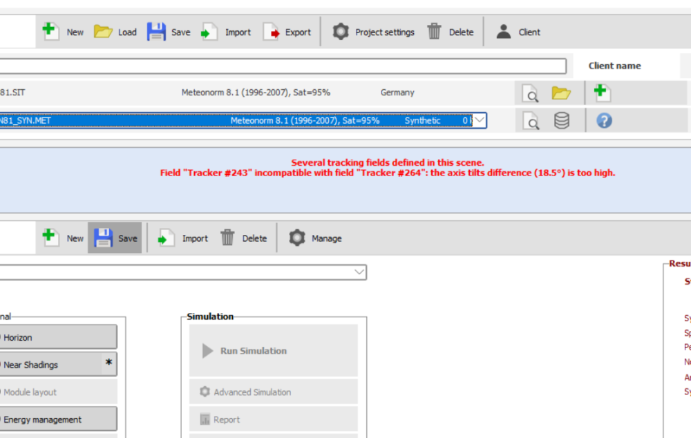

n.ragavander Posted June 25, 2024 Posted June 25, 2024 How to get an evaluation and rub a simulation from this? This design has been made with terrain following trackers using PVcase.
Michele Oliosi Posted June 25, 2024 Posted June 25, 2024 Hi, In PVsyst version 7, this error message is meant to tell you that PVsyst's calculation (which is based on a single average tracker orientation) will have some extra uncertainty given the axis tilt differences in your scene. In future versions, we plan on changing this to a warning, since there are no actionable steps other than removing the trackers that are further from the average. At the moment, we actually recommend to just change the sensitivity threshold for the message. You can easily do this by going to the home page > Settings > Edit advanced parameters. There, you can look for the following parameter: This will let you simulate. By the way, a similar parameter exists for the axis azimuth.
