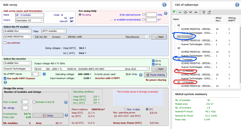

Umut Posted May 23, 2024 Posted May 23, 2024 (edited) Hi, As you can see in the picture, I have 6 different orientations but I want to connect the Orient. 2 and 4 in the same string and also The Orient. 5 and 6 in the same MPPT input (without optimizers) to see affect to energy producing. However, I couldn't find that how to set this Configuration. Is this possible ? Could you help me ? Edited May 23, 2024 by Umut
Linda Thoren Posted May 23, 2024 Posted May 23, 2024 Hello, It is not possible to have multiple orientations on the same string. If you have two or more strings, it is possible to put two orientations on the same MPPT input by using the Mix orientation 1 and 2 option (you might have to change the order of the orientation since it in this version of PVsyst is only possible to mix orientation 1 and 2). Kind regards
