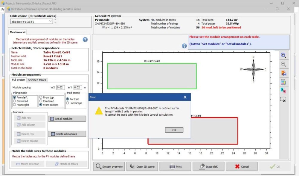

Nikoloz Posted May 23, 2024 Posted May 23, 2024 (edited) Hello I have problems with module layout with Astro energy PV modules. No problems with other brands with same orientation and location , mostly we are using JA solar modules. I don't understand what is wrong with it please see attached screen Edited May 23, 2024 by Nikoloz
Lazare Fesnien Posted May 23, 2024 Posted May 23, 2024 Dear Nikoloz, This comes from the PAN file, can you send it to us at support@pvsyst.com ? Regards
Nikoloz Posted May 27, 2024 Author Posted May 27, 2024 @Lazare Fesnien Hello i have sent you a PAN fil for this PV modules
